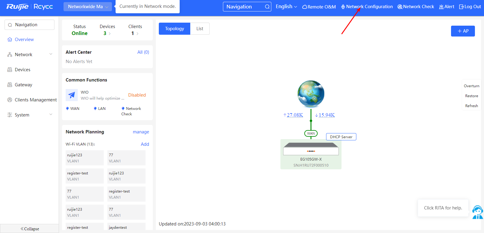

Please try to do network setup here to see whether can find the other 9 APs. And manually add them to the same network segment:
If they can not be detected with each other, you may need to check whether their IP address can be accessed with each other. If the switch is online on cloud, please help share with me your network to my email to further check this issue: yujiamin1@ruijie.com.cn.
