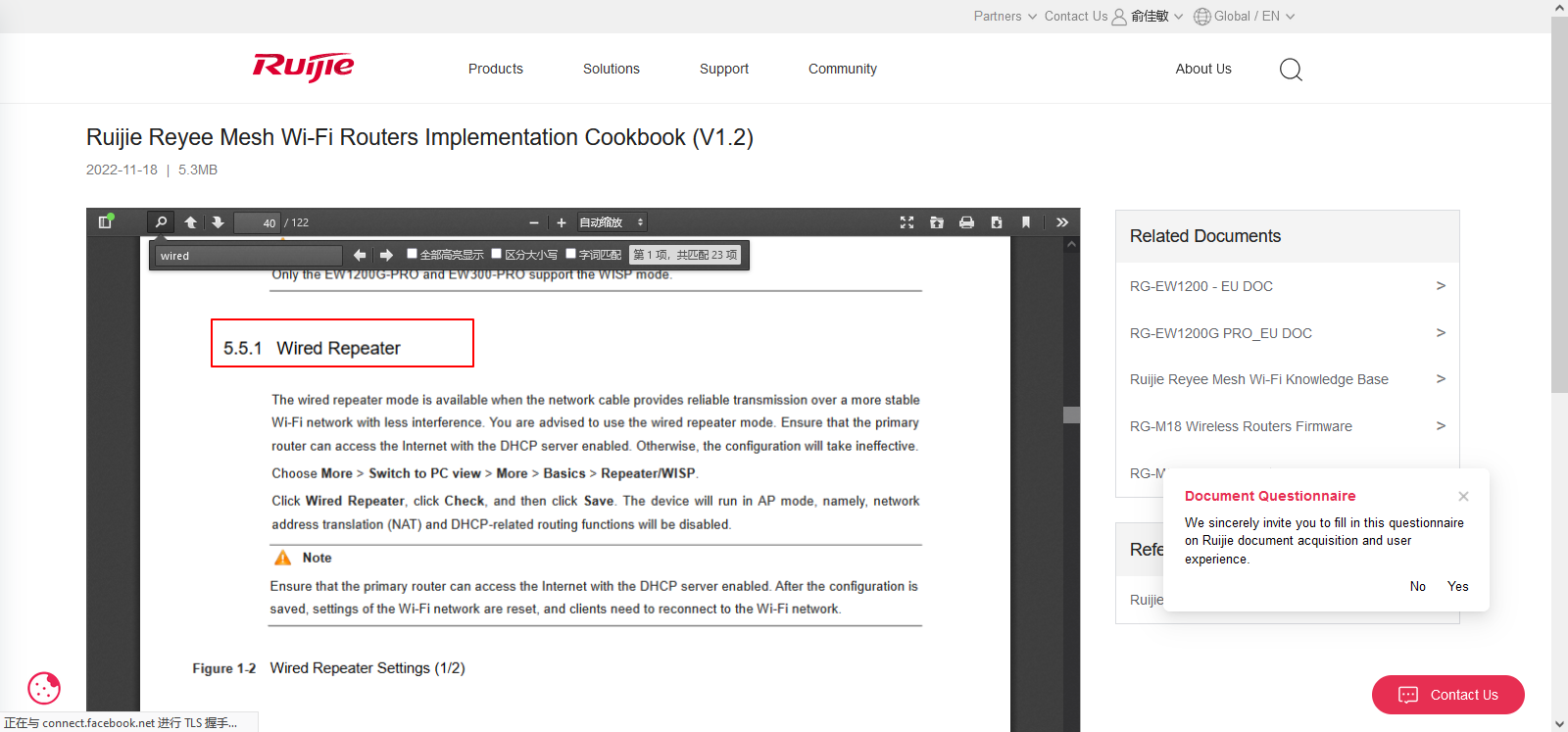

Mesh wifi
Is it possible to mesh WiFi with a cable connection?
EW1200R
Router Mesh Wi-Fi
0 2023-9-11 17:16:06 View all replies
Yes, you can configure wired repeater mode to achieve  this function. You can configure it following this guide on page 40:  https://www.ruijienetworks.com/resources/preview/77306
Best regardsJenny

GTAC-Jenny replied at 2023-9-11 17:16
Yes, you can configure wired repeater mode to achieve  this function. You can configure it ...

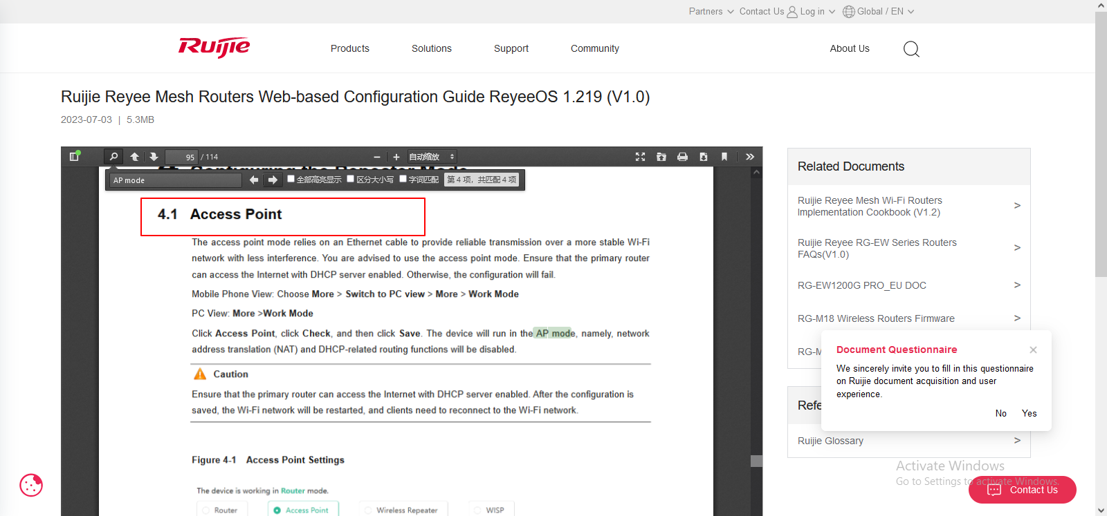

I have 3 routers, do I have to set them one by one to wired repeater
or what?
0 2023-9-14 21:12:08 View all replies
daffa umar replied at 2023-9-14 20:55
or what?
Yes, you can follow this guide to configure wired repeater mode on the router on page 95:
https://www.ruijienetworks.com/resources/preview/ruijie-reyee-mesh-routers-web-based-configuration-guide
