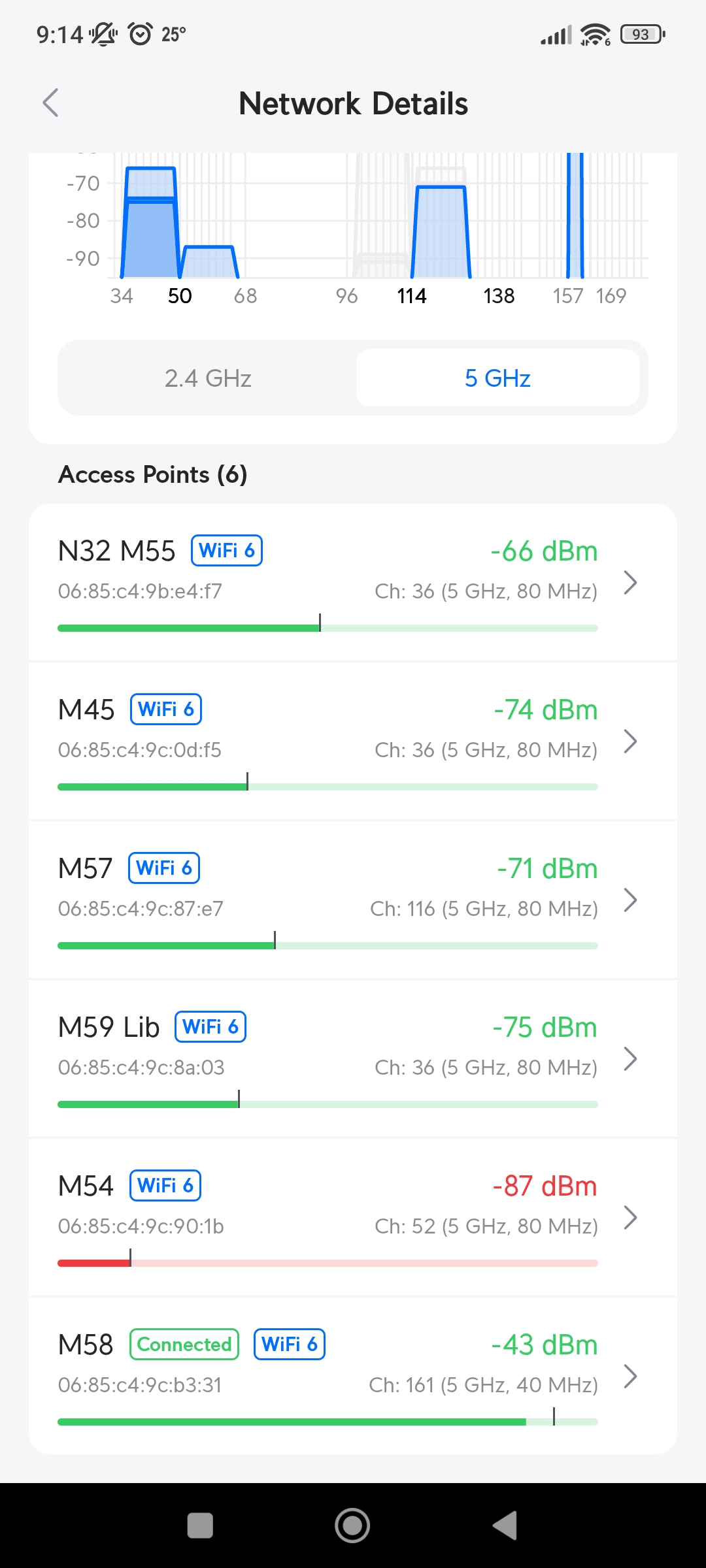

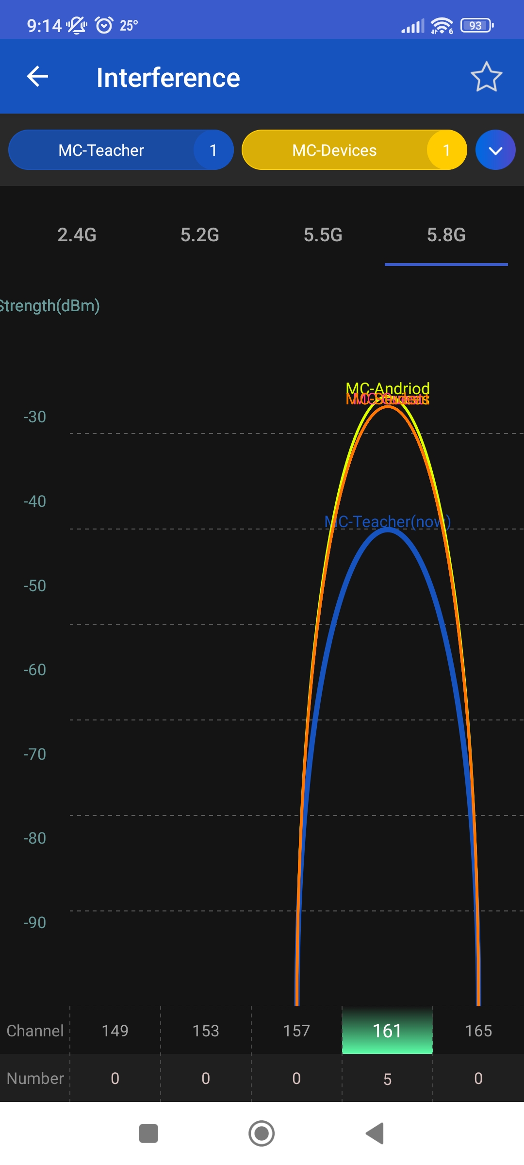

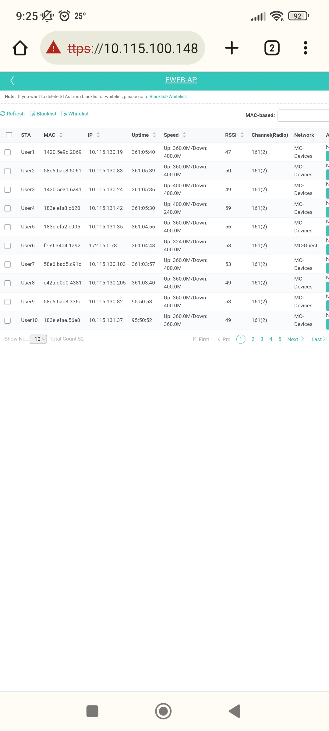

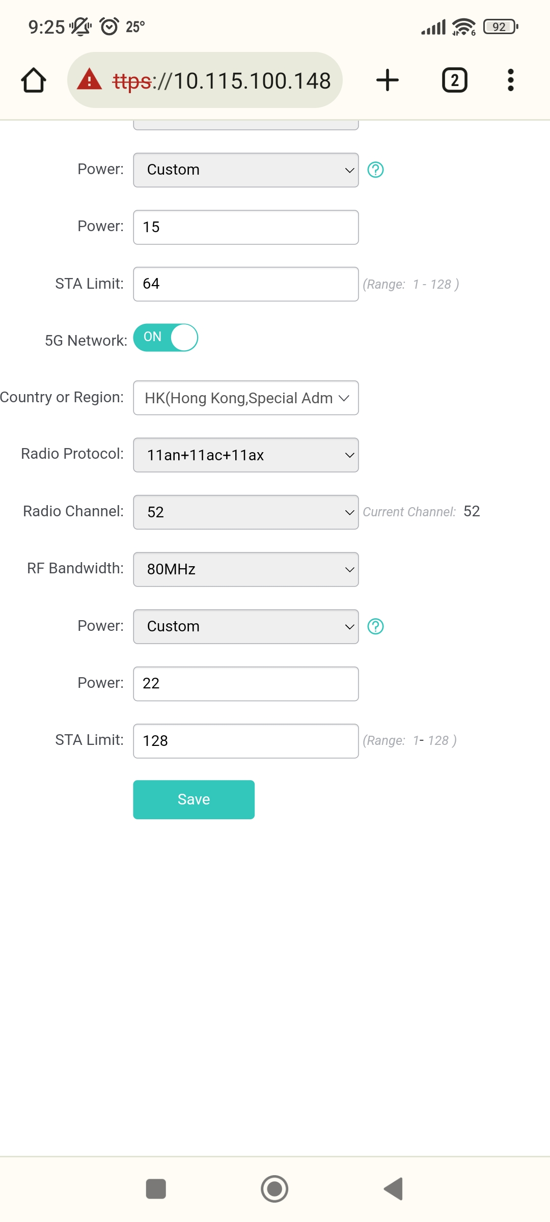

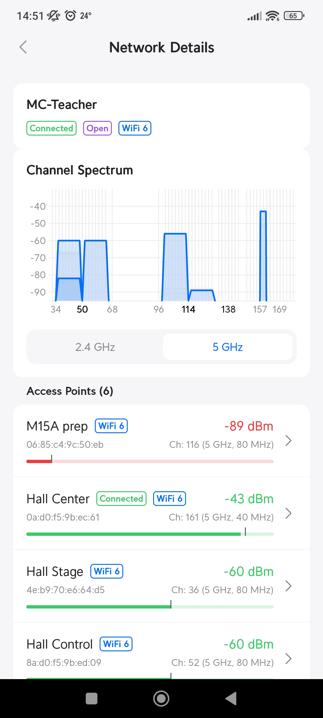

May I confirm with you please? when device web shows channel 52, bandwidth 80, then the APP shows channel 161, bandwidth 40, right? what is cloud shows at this time?
0 2023-10-10 15:52:58 View all replies
GTAC-Micca replied at 2023-10-10 15:35
May I confirm with you please? when device web shows channel 52, bandwidth 80, then the APP show ...
Web Cloud Config show: 52
APP Cloud Config show: 52
AP HTTPS admin page config show: 52
AP HTTPS admin page connected clients show: 161 (40mhz)
Wifimain app and ruijie moho show radio: 161 (40mhz)
