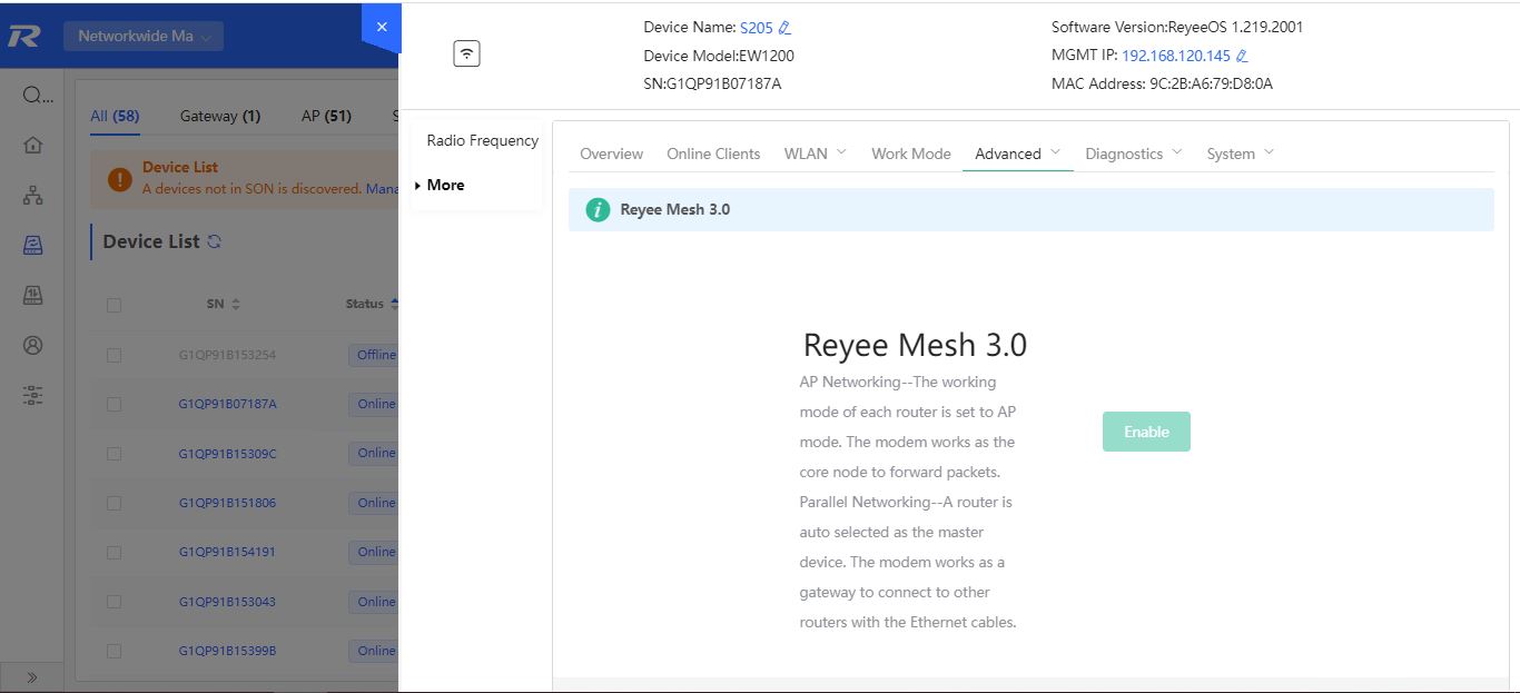

You can try to disable reyee mesh function by clicking More> Advanced > ReyeeMesh to avoid the router automatically mesh.
Jenny
0 2023-9-27 13:07:35 View all replies
GTAC-Jenny replied at 2023-9-22 15:07
You can try to disable reyee mesh function by clicking More> Advanced > ReyeeMesh to avoid ...
Doesnt work....
0 2023-9-27 13:39:23 View all replies
Sorry EW routers in the latest firmware version can not support disabling this function. Sorry for the inconvenience.

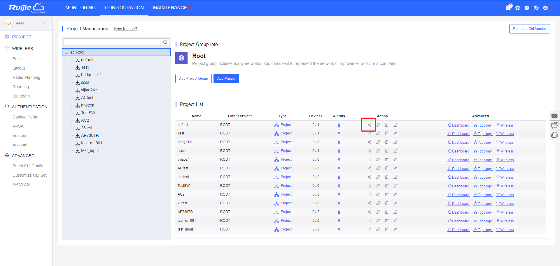

Okay I will feedback your requirement to our team. You may share with me the router network so that our R&D can login to it remotely to disable that option. You can share with to my email: yujiamin1@ruijie.com.cn. Sorry for making you any inconvenience.
Jenny
0 2023-9-27 15:12:27 View all replies
GTAC-Jenny replied at 2023-9-27 15:00
Okay I will feedback your requirement to our team. You may share with me the router netw ...
Emailed shared with shared linked. Thank you. Very urgent - critical...

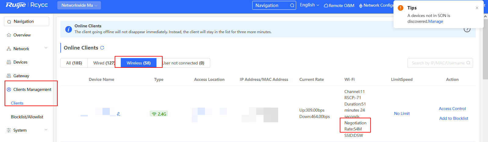

1. Yes all EW routers have the same issue.
2. I and users are standing right next to EW router. I tested myself
3. I did wifi optimization already - no difference.
4. What I saw is that mobile phones, notebooks, wifi cameras that using 2.4Ghz - Speed test 0Mbps
Devices that uses 5Ghz works much better and get good Speed test 40-200Mbps
Its seems like the 2.4 Ghz is having the most problems....not sure why. Maybe because Mesh is on

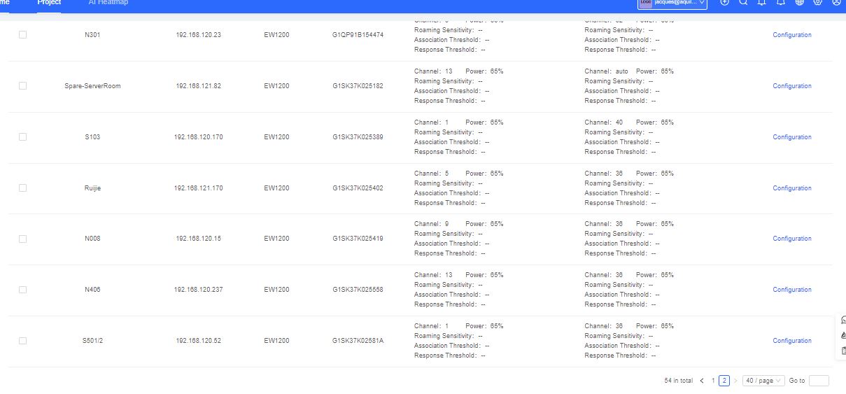

Here are some suggestions when you adjust the settings:
(1) The AP power must be appropriate and the signal is not interrupted between the aps. The ideal signal strength is -65dbm in AP coverage area edge
(2) The adjacent AP channels must be non-overlapped channel to avoid same frequency interference and packet loss. For example in non-high-density deployment scenarios, 2.4G channels are recommended to use 3 non-overlapping channels 1, 6, and 11 for planning. If it is a high-density deployment site, it is recommended to use 4 channels 1, 5, 9, and 13 for planning.
Jenny
0 2023-9-27 17:58:39 View all replies
GTAC-Jenny replied at 2023-9-27 16:30
Ok I have configured 4 channels  1, 5, 9, and 13 and  signal strength is set to 65 dbm  .... lets see if it works

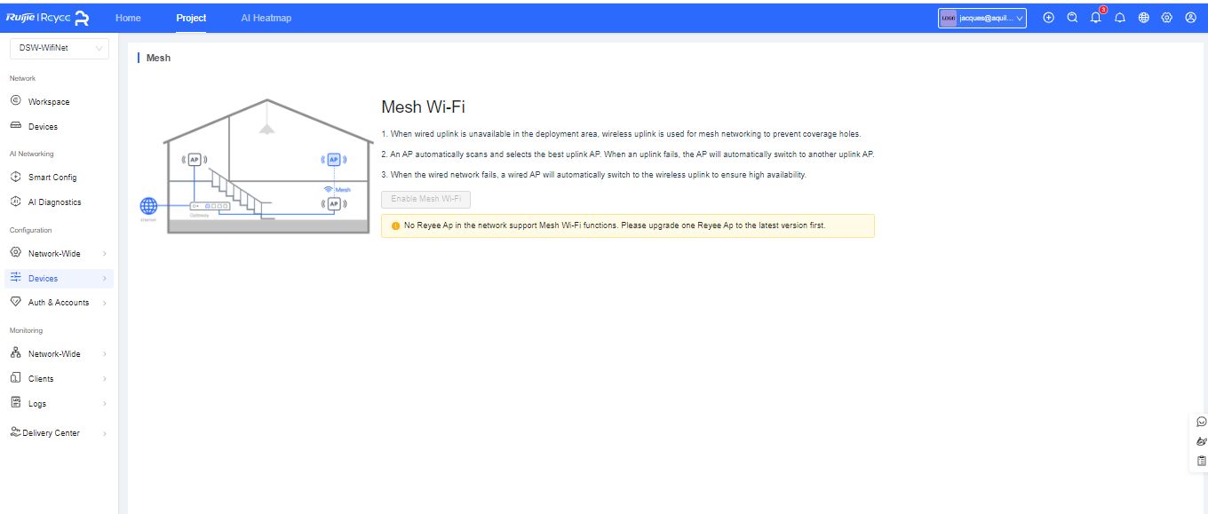

R&D Team disabled the Wifi Mesh on Ruijie Cloud. This resolved the wifi problems. 2.4Ghz & 5Ghz device can now and good internet speeds. Please do not enable Wifi Mesh in the future....Remember this !!!!!!
