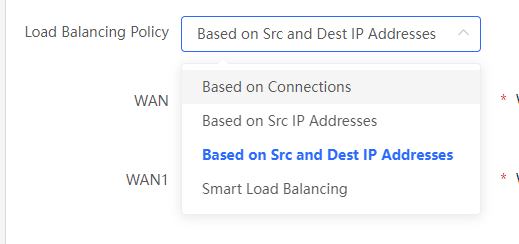

How would I choose to do a failback? I have to ISP's, on WAN0 and WAN1. I tested the FAILOVER and it works, however the FAILBACK did not. When WAN0 has recovered it stayed in WAN1.
Can someone explain how would I go about choosing a Load Balancing Policy?
Also, can you explain the differences between these 4
TIA

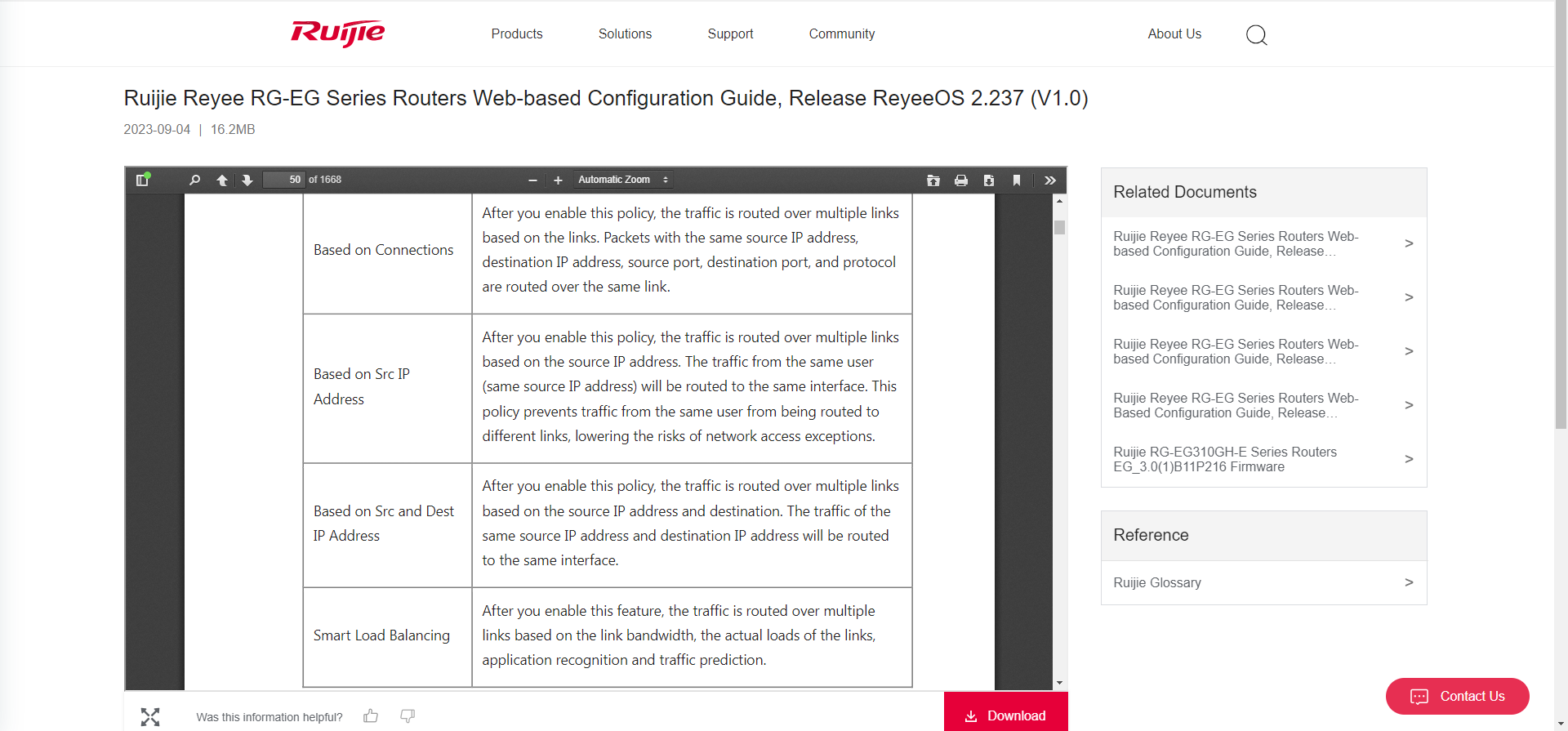

Please refer to page 50 of https://www.ruijienetworks.com/resources/preview/ruijie-reyee-rg-eg-series-routers-web-based-configuration-guide-release-reyeeos-2-237 for the difference between different load balancing policy:

GTAC-Jayden replied at 2023-9-23 15:43
Dear User 48367,
Please refer to page 50 of https://www.ruijienetworks.com/resources/preview/ruijie ...
The help option found on the eWeb is THE SAME on the page 50 and this document and neither explains how I would go about a failback option nor a documented explanation if Active/Secondary has one. That option/feature should have been OOTB.
0 2023-9-23 19:15:09 View all replies
User 48367 replied at 2023-9-23 18:28
The help option found on the eWeb is THE SAME on the page 50 and this document and neither explain ...
