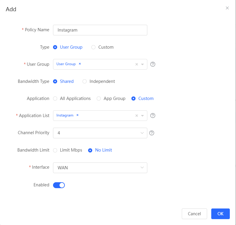

There is something like this in the Flow Control of the gateway.
Just tried with EG105G; here´s what i get:
Seems you can choose the interface for each application.
I have not confirmed though.
Maybe you can try.

I just tried this setting. Does not seem to do what you want.
I think the setting in the flow control just means which interface will be rate limited.
There is a PBR setting (this would be used in such case), but unfortunately it does not seem to be able to match applications.

Sorry for the inconvenience , at present, EG cannot specify the corresponding WAN port according to the traffic of the APP. We will give feedback on your needs.
