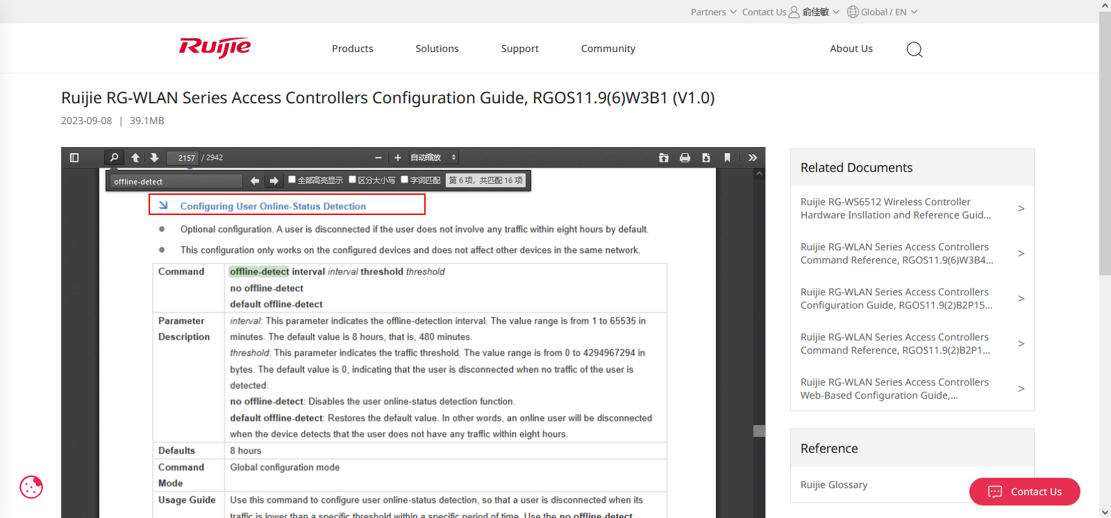

You can refer to this document about the offline detect commands on page 2157 to check whether you have configured it successfully: https://www.ruijienetworks.com/resources/preview/ruijie-rg-wlan-series-access-controllers-configuration-guide-rgos11-9-6-w3b1
