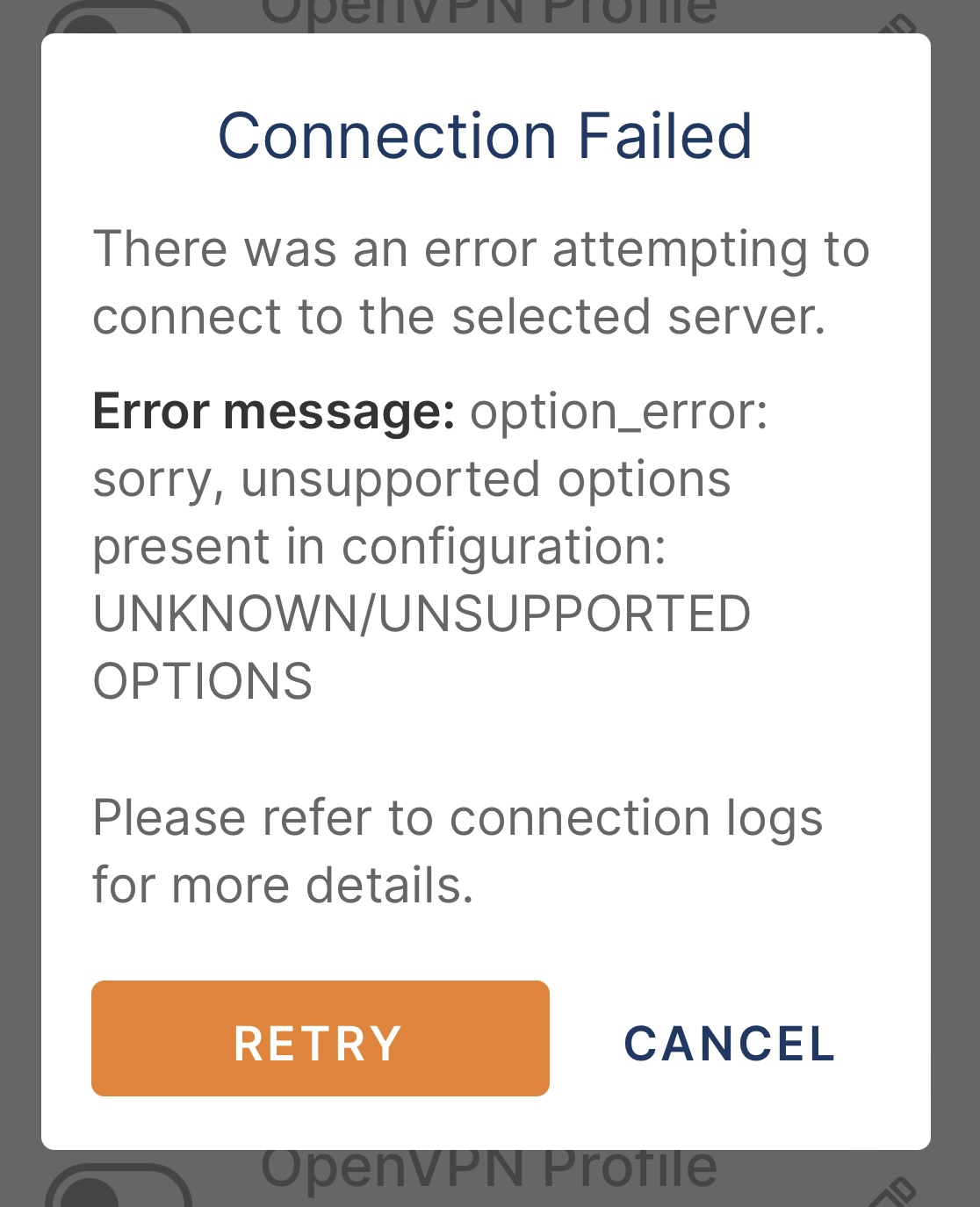

After update my iphone openvpn connect app to 3.4.0, when connect this error appears.
anyone can help to fixed this issue, thanks!

Just fixed the issue by remove below directive from .ovpn config file
--> log openvpn.log
--> status openvpn-status.log
--> route-delay 2

Hi sir,
May I know the SN of your device? Now your phone can connect to openVPN, right?

Hi Steve,
Now my phone can connect.
