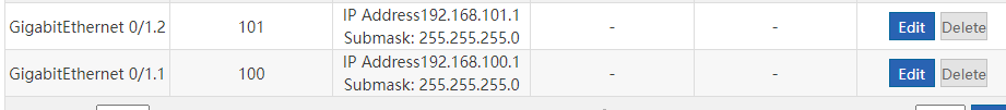

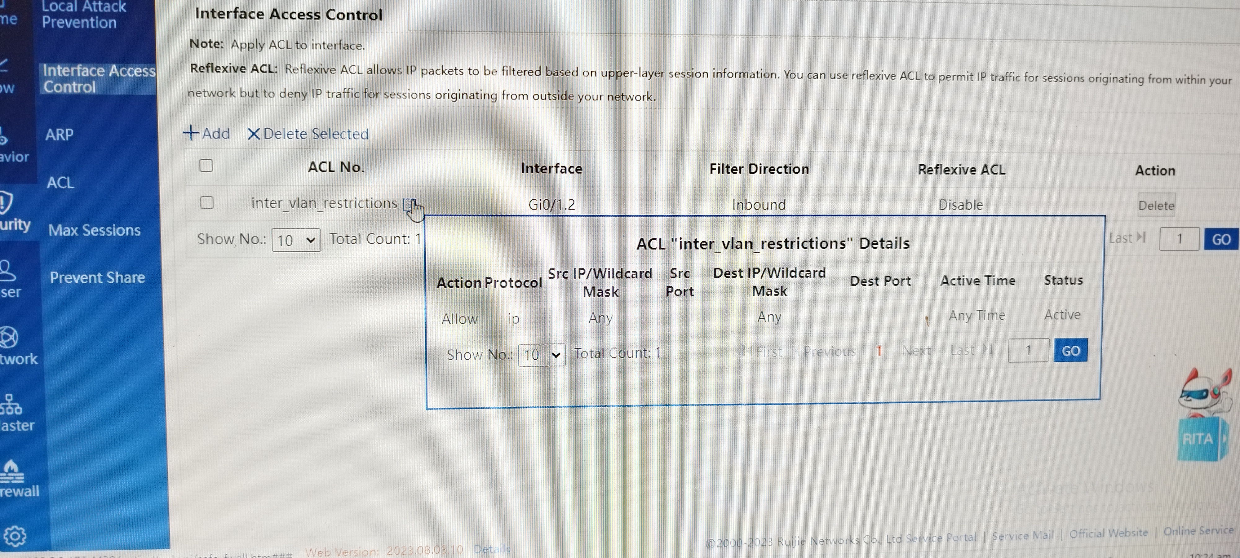

i have two subnet 100.0/24 and 101.0./26 and the client pc from 100.2 cant ping to 101.11 i add new acl all permit as a test allow all and in interface access i add inbound to Gi0/1.2 which 101 belong to this vlan did i missed something here? thanks

please ignore this reply of mine it works now
