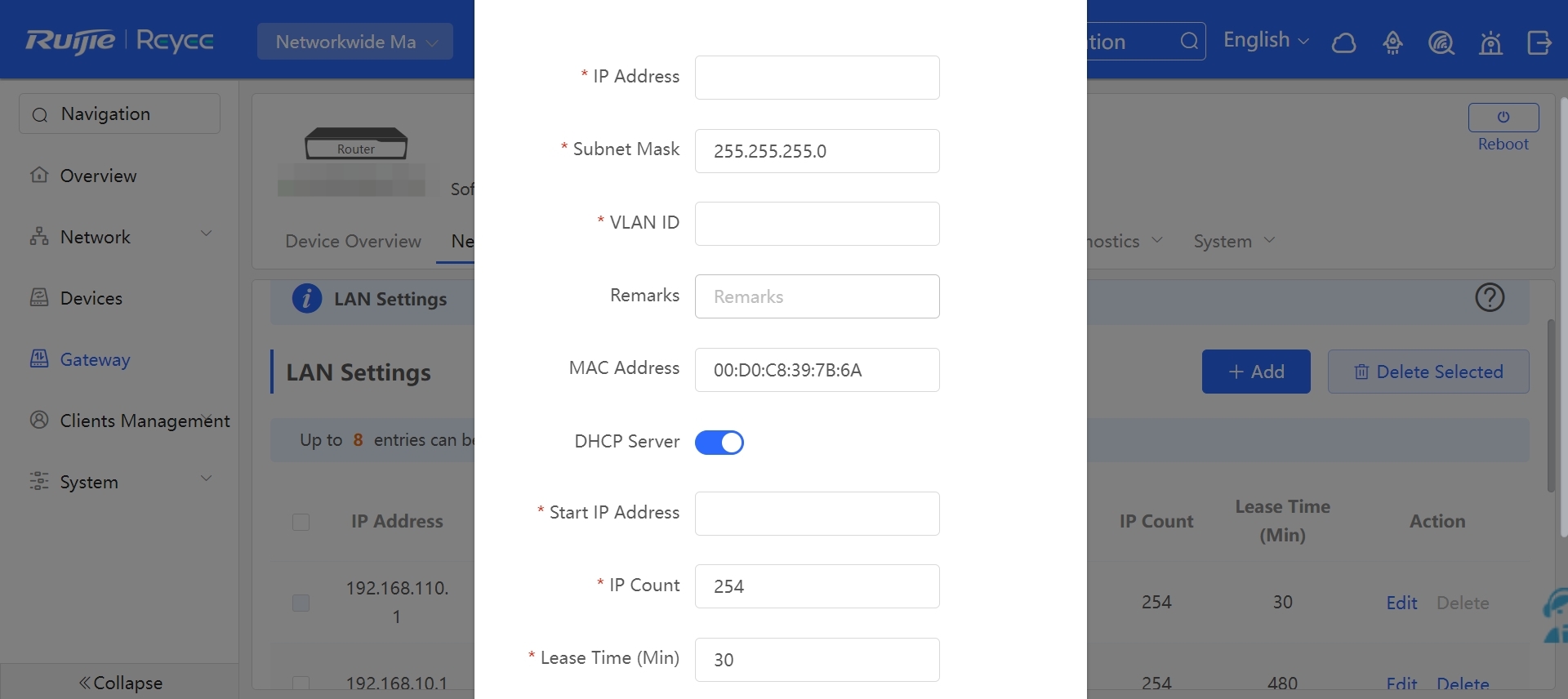

How to create a local network without Internet access on EG105GW?

Log in to the device in wired mode: (1) Connect a PC to a LAN port of the EG. (2) Configure IP addresses of the PC and management interface to be on the same network segment. (3) Visit ​​[url]http://10.44.77.254[/url] or 192.168.110.1 through a browser. (4) Enter local web of the EG
gateway-network-LAN--add, then you may create local network

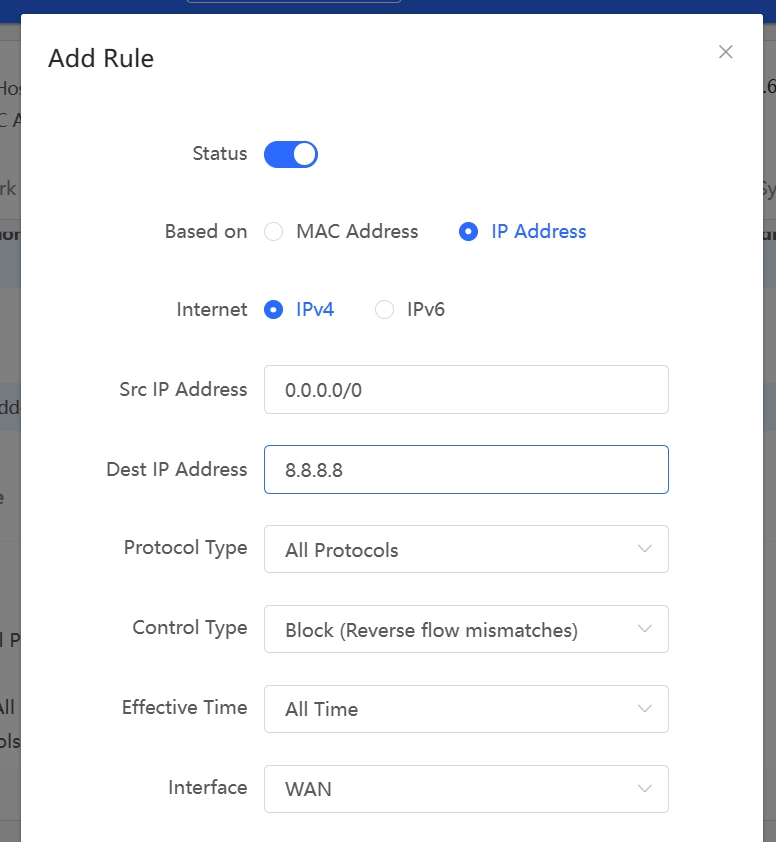

Tell me how to make sure that there is no access to the Internet on this local network

Is it possible to programmatically restrict local network access to the Internet?
Dear,
Yes, please kindly make sure the gateway has not configured the NAT, and also you can set an ACL to block the traffic. If you want to block all traffic, please input 0.0.0.0/0 or input the ip range you don‘t want them to acess the internet. The destination ip adress is 8.8.8.8.
