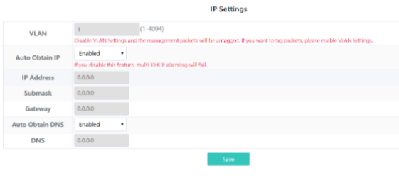

May I know whether only the ES switch is offline on cloud and other devices are online normally? Please help login to the ES switch local web interface to further check its IP address and DNS server settings on this page.
