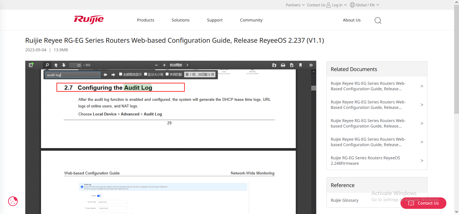

You may try to configure audit log on the EG via this guide on page 33 and check whether it can achieve your function:
https://www.ruijienetworks.com/resources/preview/ruijie-reyee-rg-eg-series-routers-web-based-configuration-guide-release-reyeeos-2-237-en
If it can not work, please help confirm your EG firmware version and what protocol your SIEM server use with this function so that I can further check whether it is compatible with our EG. Thank you for your cooperation.
