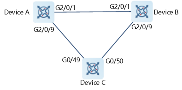

4.1.2 Network topology diagram
Figure 4-1
4.1.3 Key points of configuration
Device A and Device B act as aggregation devices, and Device C acts as an access device. User devices can be connected to Device C in downstream. The three devices form a ring network topology. Each device enables STP (Spanning Tree Protocol), and the STP configuration can refer to the relevant configuration guide.
Device A enables RLDP. Two ports need to be configured for unidirectional and bidirectional link detection, and the downstream port needs to be configured to enable loop detection.
Device B enables RLDP, and both ports need to be configured for unidirectional and bidirectional link detection. The downstream port needs to be configured to enable loop detection.
When Device C enables RLDP, the two upstream ports need to be configured for one-way and two-way link detection, and the two downstream ports need to be configured to enable loop detection.
