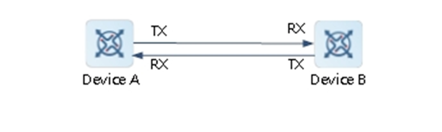

4.2.1 networking requirements
As shown in Figures 4-2, devices A and B are connected by optical fibers, and the two lines in the figure represent the Tx and Rx lines of the optical fibers respectively. A and B enable the RLDP unidirectional link detection function. If either the Tx of port A and the Rx of port B or the Rx of port A and the Tx of port B fail, the protocol can detect the unidirectional fault and take corresponding actions. If the fault is recovered, the administrator can manually restore the protocol status on A and B and restart the detection.
4.2.2 Network topology diagram
Figure 4-2
