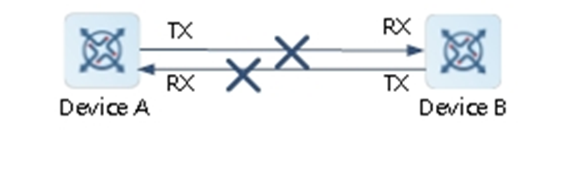

4.3.1 Networking requirements
As shown in Figures 4-3, devices A and B are connected by optical fibers. The two lines in the diagram represent the Tx line and Rx line of the optical fiber, and A and B enable the bi-directional link detection function of RLDP. If both the Tx of port A and the Rx of port B, as well as the Rx of port A and the Tx of port B, fail at the same time, the protocol can detect the bi-directional fault and take corresponding actions. If the fault is restored, the administrator can manually restore the protocol status on A and B and restart the detection.
4.3.2 Networking topology diagram
Figure 4-3
4.3.3 Key points for configuration
