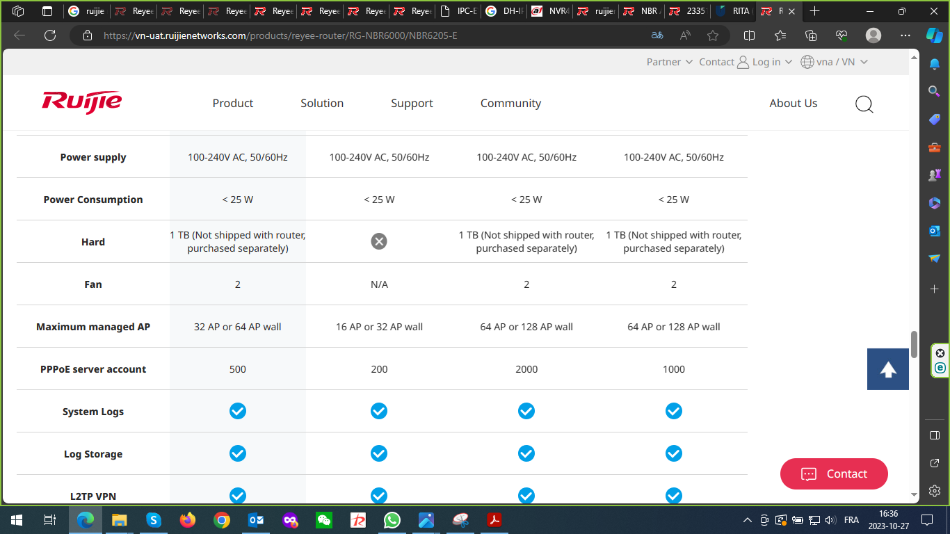

If i have many AP without Wifi6. how many AP with captive portal can the NBR Support ?

How About This number of AP  attached in the datasheet of NBR ?
Dear,
This model does not support this feature. You may want to check the latest datasheet here.
Really sorry for the incovenience caused to you.
RG-NBR6000 Series Datasheet - Ruijie Networks
