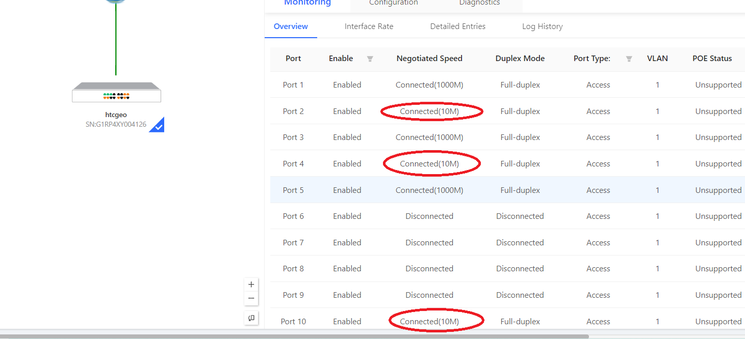

hi,
some port are running on 10mbps
how to know what is the cause ?
RG-ES216GC
Switch
0 2023-10-29 21:48:05 View all replies
Dear Mobit Ong,
May I please know what devices are connected to these ports? Do the peer devices support an auto-negotiation rate of above 10M?
You may please replace the cable and check if the port speed can be negotiated normally.
If the switch firmware version is not the latest, you may try upgrading the switch firmware to the latest version which you can download from the link below:
https://www.ruijienetworks.com/resources/software/rg-es216gc-es224gc-1p21-firmware/rg-es216gc-es224gc-1p21-firmware/
Jayden
0 2023-10-30 00:28:43 View all replies
GTAC-Jayden replied at 2023-10-29 21:48
Dear Mobit Ong,
May I please know what devices are connected to these ports? Do the peer devices su ...
Alternative to Jayden's response.
You may also check if your cables are terminated correctly. Badly or incorrect cable termination can effect speed.
Also check the cable distance it has to travel.
