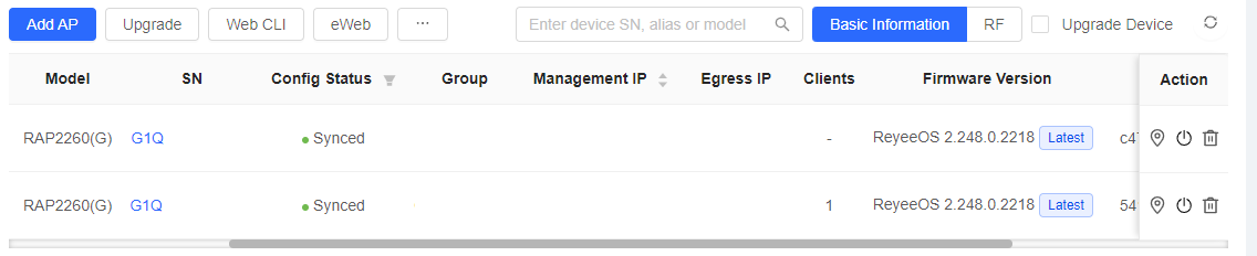

Okay, thank you for the explanation.
Maybe I'll do a firmware update first (I think it's the latest).
If it doesn't work later, I will contact RITA as suggested.
