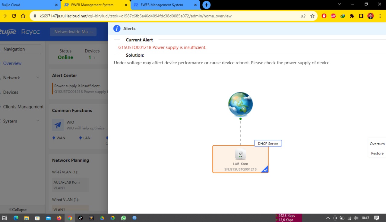

POWER INSSUFICIENT
5847 3 2023-11-2 18:06:24
why the AP show alert like this?RAP2260(G) with PoE adaptor AT30

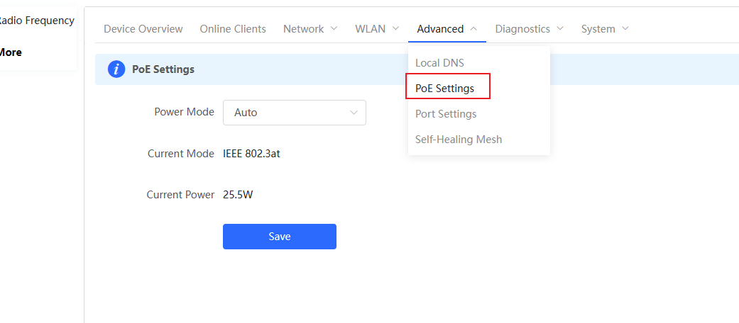

May you take the screenshot of this page for me please? Please change it to AT if it is auto( of af)

Have you changed the POE mode and any issue so far? If there are still alart, you need to replace the adapter. The AT30 is a non-standard POE while RAP2260(G) use standard POE
