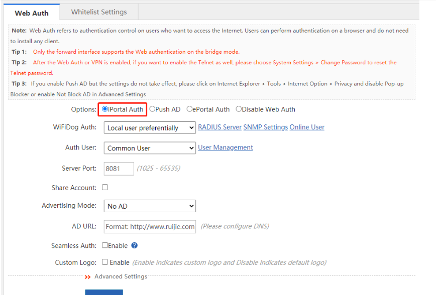

If your model is RG-EG3230/RGEG3250, you can check steps below.
You may refer to any of the following paths to use the captive portal autentication:
Web authentication:
You need to choose iPortal auth
(or ePortal auth, regarding your needs)  in your ruijie EG to use captive portal configuration. Follow the path: User > Web auth > Web auth

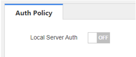

Local Server Authentication
If you want to use your device as local server auth, need to enable this part, please follow the path: User > Local auth > auth policy

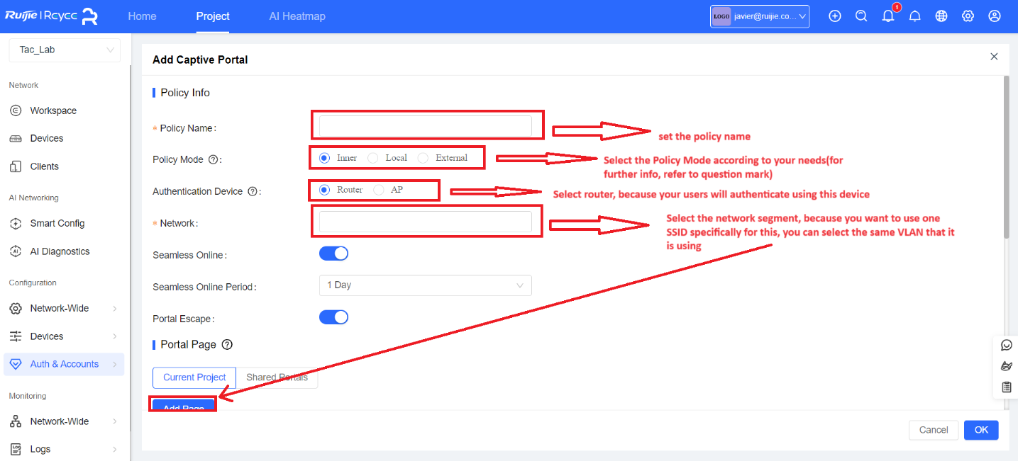

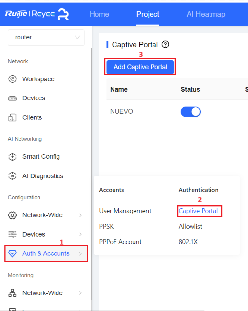

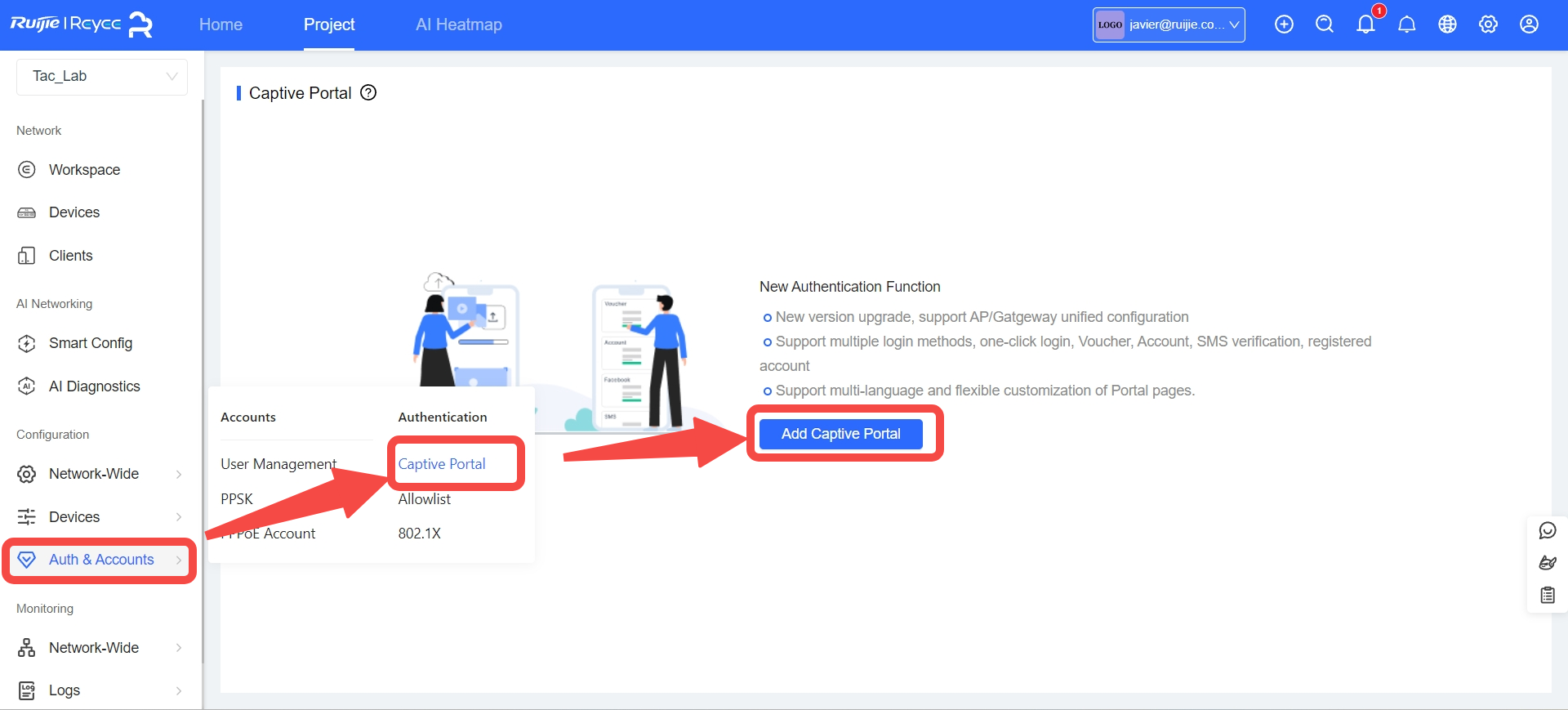

Dear:
According to your explanations, you can proceed as follows:
1. Follow the path: Auth & Accounts > Captive portal > Add Captive Portal:
2. Fill out the blanks:

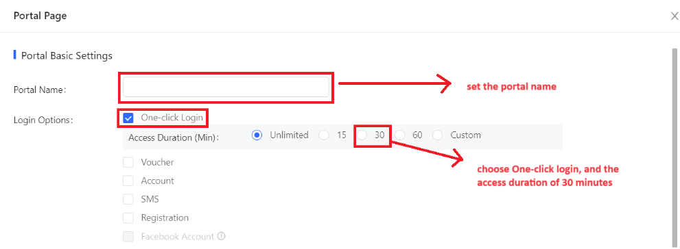

3. After clicking on Add page, if you only want to use the portal to give access to your customers to use e-wallet, it is recommended to use one-click login if no need to collect extra information, so follow these directions:
If need to consider another Login options for your purposes, you can do it.
