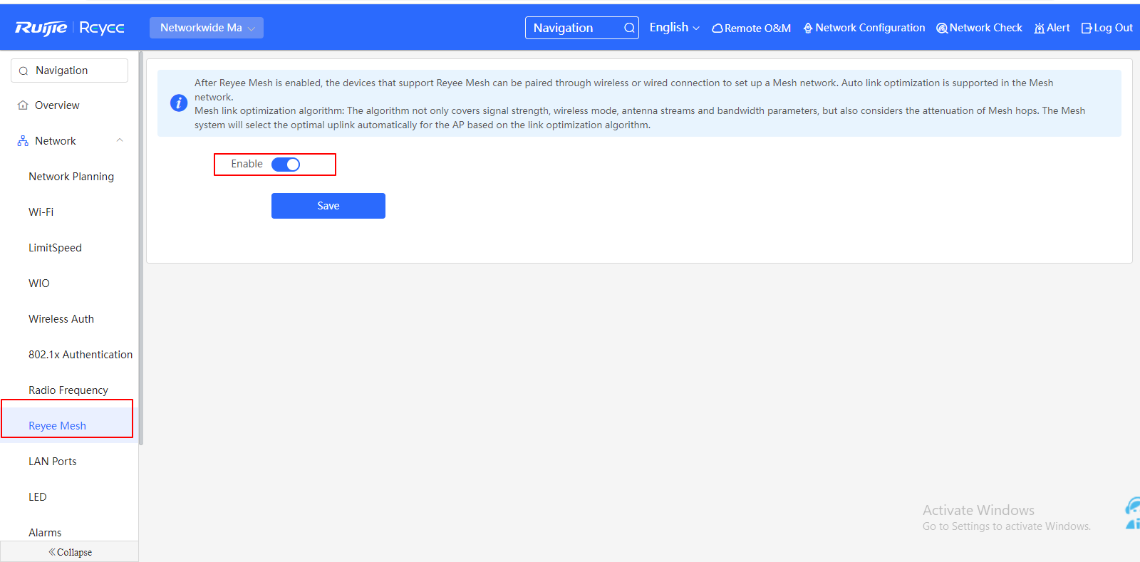

Hi ,  we are using AP model
is RAP2260. Does the AP have mesh function? Because our mobile devices in the company are not automatically switching to the optimal AP based on signal strength when moving within the system.
If the AP has mesh functionality, how to check if this feature has been enabled.

Yes, RAP2260 can support AP mesh function in the latest firmware version. You can check whether the AP mesh function is enabled on this page:
You can follow this guide to configure AP mesh:
https://community.ruijienetworks.com/forum.php?mod=viewthread&tid=4332&page=1&extra=#pid7525
----> For this issue, this is the client behaviour to choose which AP to connect to, we may need to adjust the AP transmit power and the deployed location and further test roaming to check.

Hi Jenny,
Thanks for reply, But the AP Mesh function has always been enabled. However, it seems that the mobile devices are still not automatically switching to the AP with the strongest signal. Are there any other settings that need to be addressed to enhance the effectiveness?
Thanks

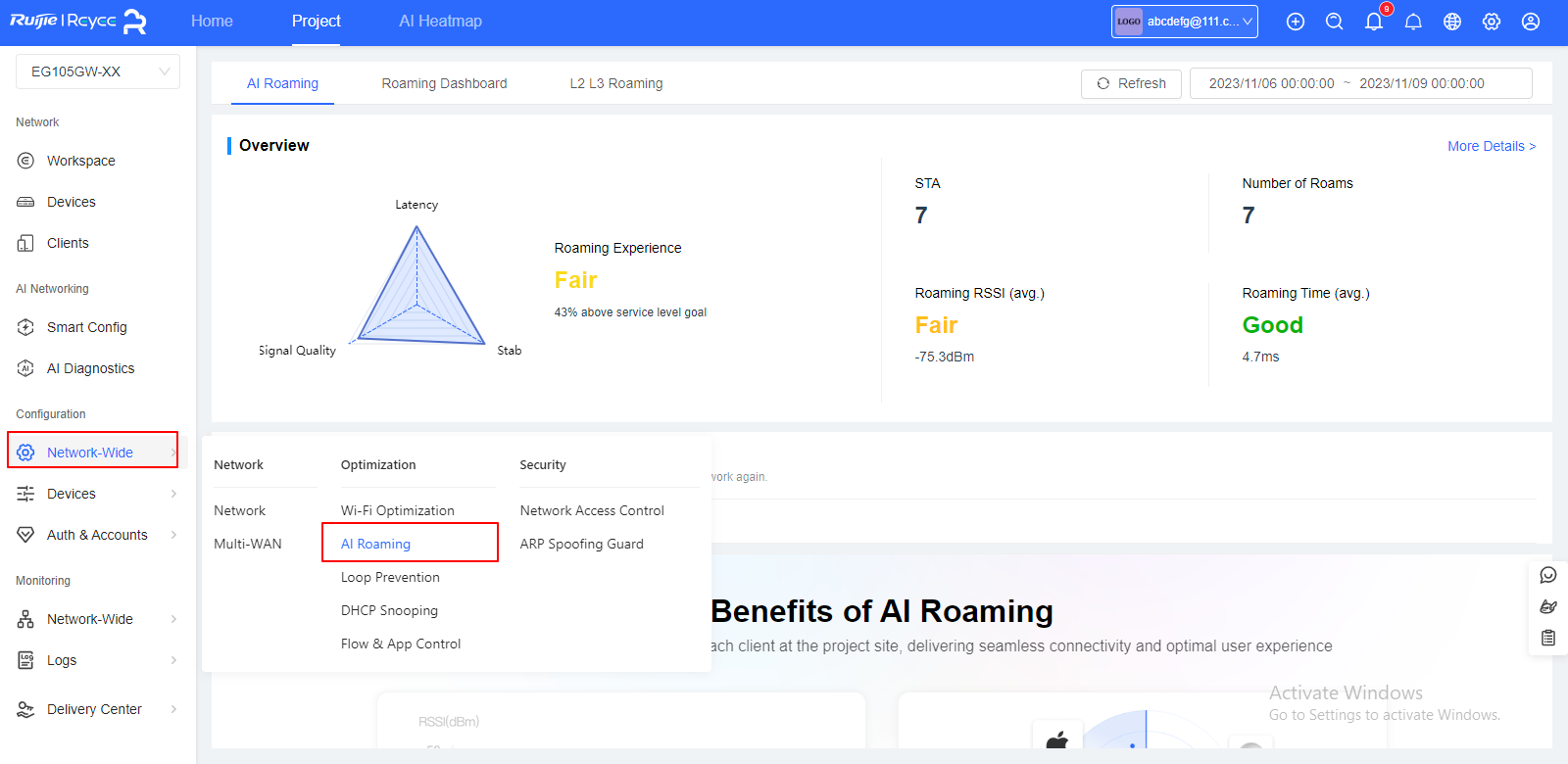

You can try to enable AI roaming here to guide the wireless clients connect to the optimal AP to get the better wireless performance.
If the problem still exists, please contact with us on Rita Live(https://www.ruijienetworks.com/rita ) for this problem to solve your problem faster.
