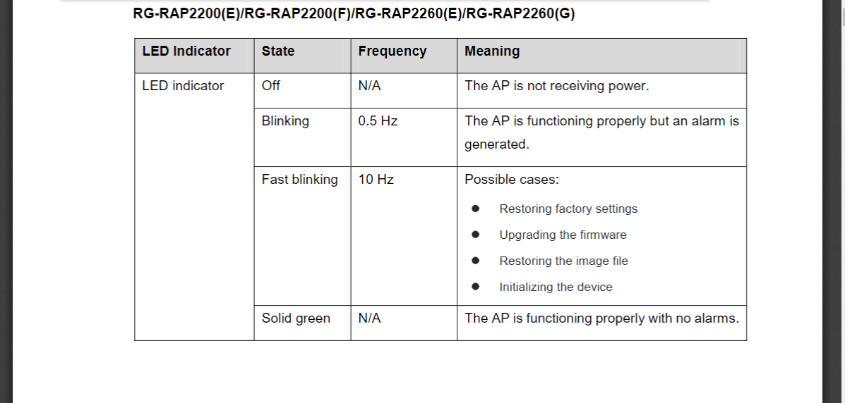

Dear,
please take a look at the picture here that explains the meaning of LED:
we may need more information to further investigate the cause of the problem, please provide more details if possible
