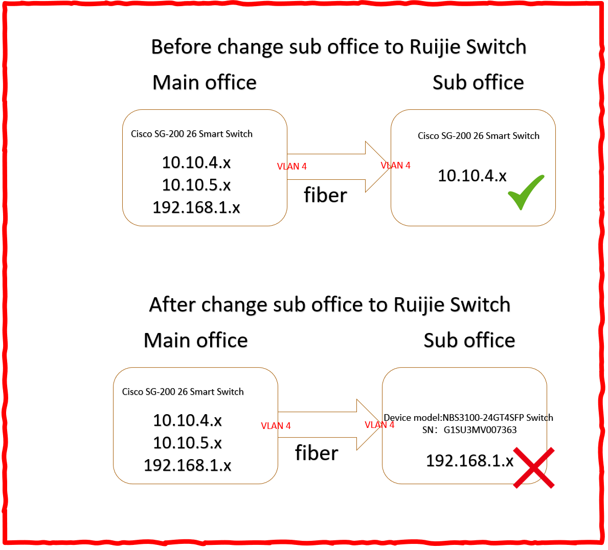

i had customer that install cisco switch at main office and sub office and link them via fiber cable.
last week we had change the sub office switch to ruijie and had configure the correct VLAN.
we are able get dhcp 10.10.4.x on sub office previously, but now with ruijie switch we are only get 192.168.1.x .
how to get the dhcp 10.10.4.x  on sub office switch ?

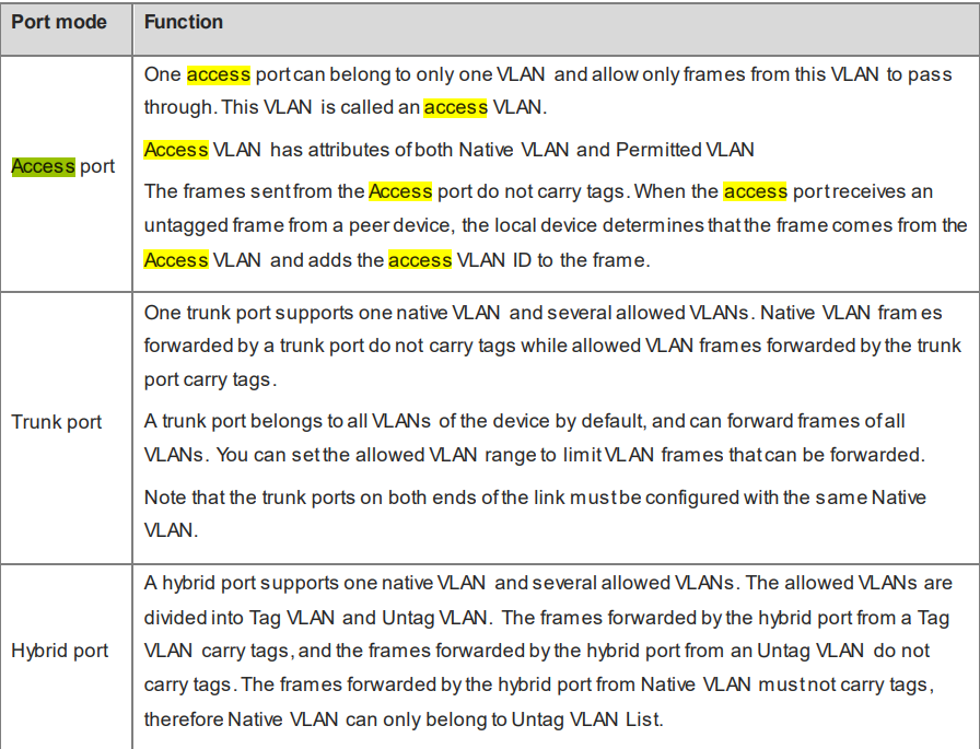

below are the port mode and native vlan and permit vlan.
what is the different between access vs trunk mode ?

Dear,
please refer to this iamge regarding this question.
