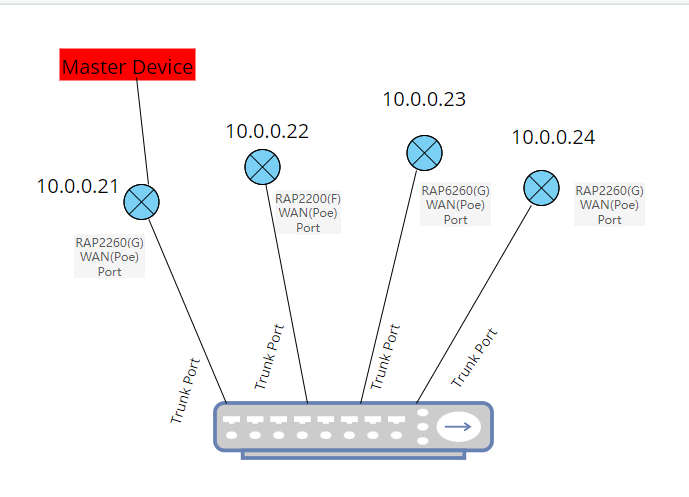

RAP Devices VLAN Configuration without Controller
5238 2 2023-11-29 05:01:44
There is a configuration similar to this. Can I broadcast many SSIDs over different VLANs via the Master device without an AP controller? All cables are on the WAN port and all are set to "Trunk" on the Switch.
RG-RAP2260(G)
0 2023-11-29 08:45:49 View all replies
Dear:
You can deploy the configuration above as long as you meet with the following
Yes, you can set different SSIDs over different VLANs via the master device without a controller, but I need to ask you: may I know where is the DHCP server? because RAP2260(G) can not act as this one. So, need to consider an uplink device that works as a gateway and DHCP server.
If this requirement is met, you can deploy it.
Regards,
Javier
0 2023-11-29 12:45:08 View all replies
GTAC--Javier replied at 2023-11-29 08:45
Dear:
Yes sir. I have a DHCP server (windows) and I set the ip helper address to all vlans.
