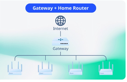

Dear Support !
Good day to you ! what are the Advantages to Use Reyee EG Series to Connect All EW Series Home Routers to AP mode Wired ?
Beside Central management and Feature as mention on this Ruijie Networks Facebook link below:
https://www.facebook.com/groups/ruijie/permalink/1846763632392757/
Can you all Expert of Ruijie or Reyee Support Engineer share us  the more  information of benefit  this connection like ?  thank you
Is there limitation how many Home Router or model of EW series can connect to Reyee EG series to it become AP mode? thank you

Dear:
It is not recommended trying to manage EW home routers using reyee EG, due to reyee EW are used on home scenarios, so for reyee EG better to use reyee APs, because they are destinated for SMB projects, so their specs and skills are better compared with EW series. You can consider the scenario you tell me as a last resource due to limitations.
Regards,
Javier
