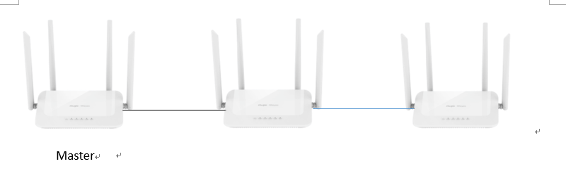

EW routers can support 3 hops to do mesh at maximum as the following picture:
Jenny

Thank you for the quick reply Jenny!
Am I already at Maximum then?
If not, will the EW3000 work together with EW1800 or are they not compatible with eachother?

Dear Louis Fourie,
The Uplink Info of the 2 repeaters shows that they are meshed with a wired connection. Please kindly note that there is no limitation on the number of devices in the wired mesh.
EW3000GX Pro is compatible with EW1800GX Pro for mesh networking.
