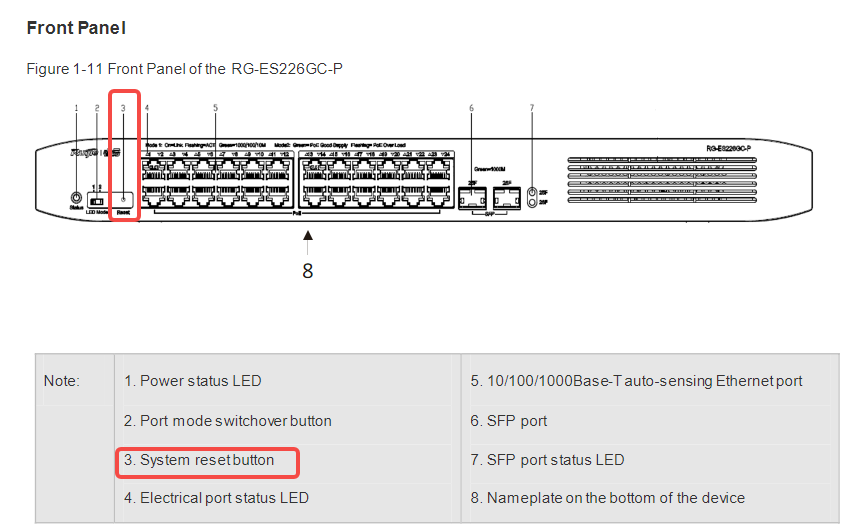

How to reset es226gc-P switch which unknown on the cloud portal
RG-ES226GC-P
Switch
0 2023-12-13 13:53:01 View all replies
Dear sir,
There is a reset button on the switch front panel:
You can reset the switch by pressing this button for more than 5 seconds or until the status LED blinks.
