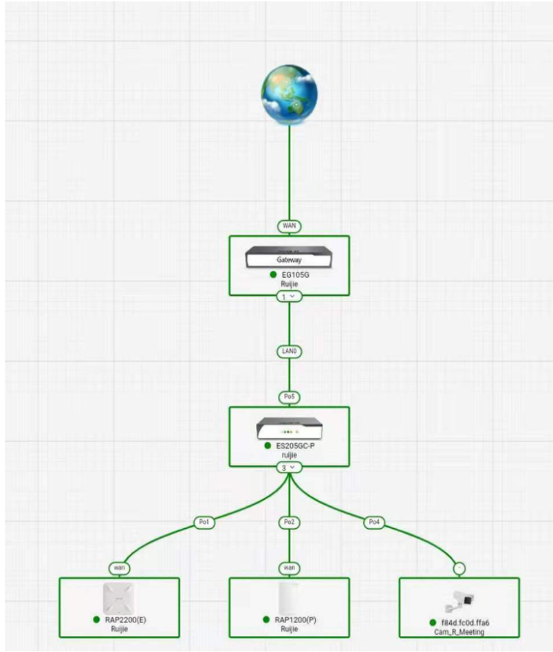

The user directly connects to the IP Cam using the ES/NBS series switch, which is not displayed in the Camera List or actual topology
2.Topology:

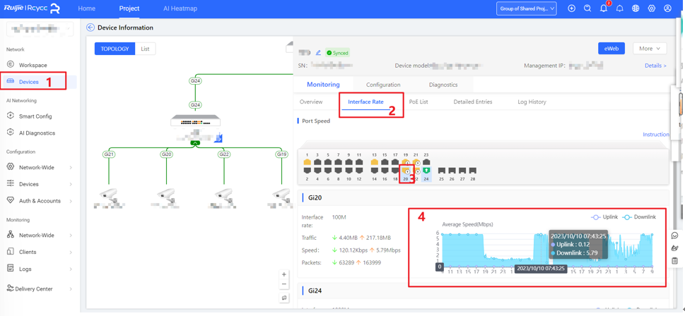

1. login to the device to check whether the corresponding port traffic is normal and uploaded stably

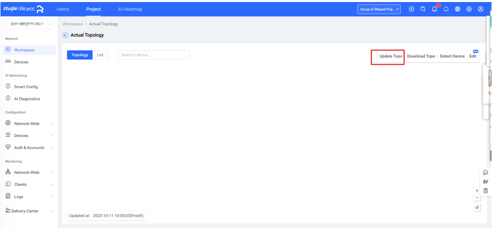

2. Confirm IP Cam connection duration. It needs to wait 20-30 minutes. If you don't see the camera in the cloud for a long time, update it manually.
