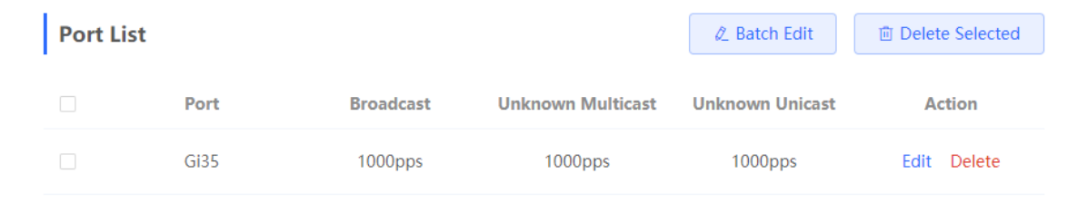

Choose Local Device > Security > Storm Control.

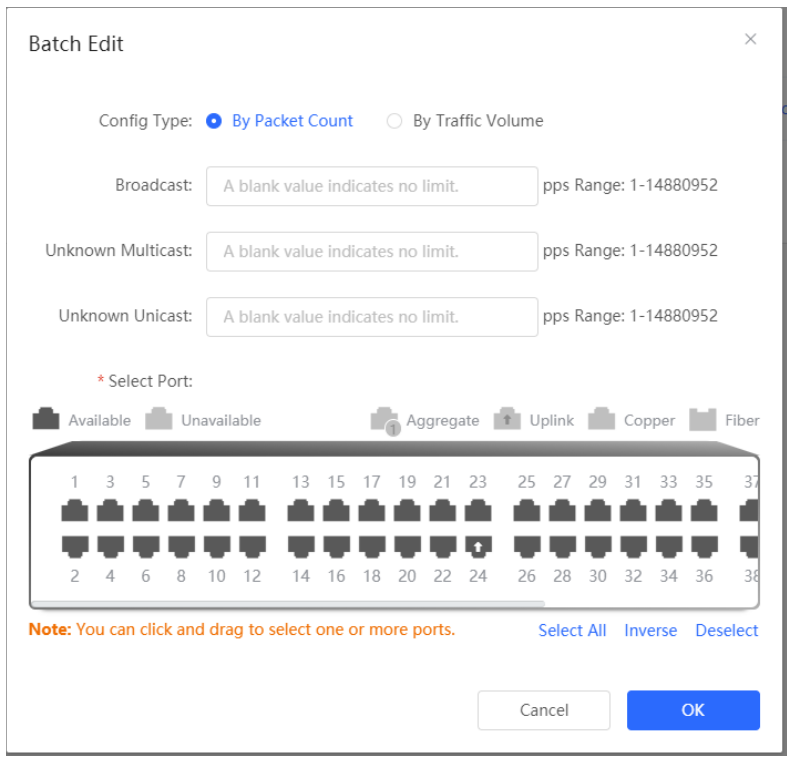

Click Batch  Edit. In  the  displayed  dialog  box,  select  configuration  types  and  ports, enter  the  rate  limits  of broadcast, unknown multicast, and unknown unicast, and click OK. To modify or delete the rate limit rules after completing the configuration, you can click Edit or Delete in the Action column.
There are two configuration types:
  • Storm control based on packets per second: If the rate of data flows received over a device port exceeds the configured  packets-per-second  threshold,  excess  data  flows  are  discarded  until  the  rate  falls  within  the threshold.
  • Storm control based on kilobytes per second: If the rate of data flows received over a device port exceeds the configured  kilobytes-per-second  threshold,  excess  data  flows  are  discarded  until  the  rate  falls  within  the threshold.
