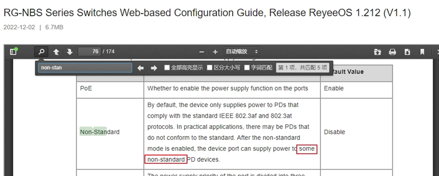

Does Reyee NBS series support passive poe? Reply
4860 0 2023-12-14 11:35:54
You can enable non-poe to support this.
Note that NBS supports 48V. Therefore, after non-standard is enabled, only 48V passive PoE is supported.
How to enable non-standard PoE on Reyee NBS Series switches?:
【New reminder】How to enable non-standard PoE on Reyee NBS Series switches? - Switch - ruijienetworks
RG-NBS3100-24GT4SFP-P
Configuration Switch
