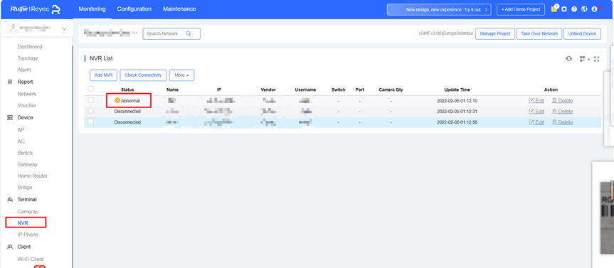

1.Issue Description:
NVR status shows abnormal on Cloud.
3.Troubleshooting:

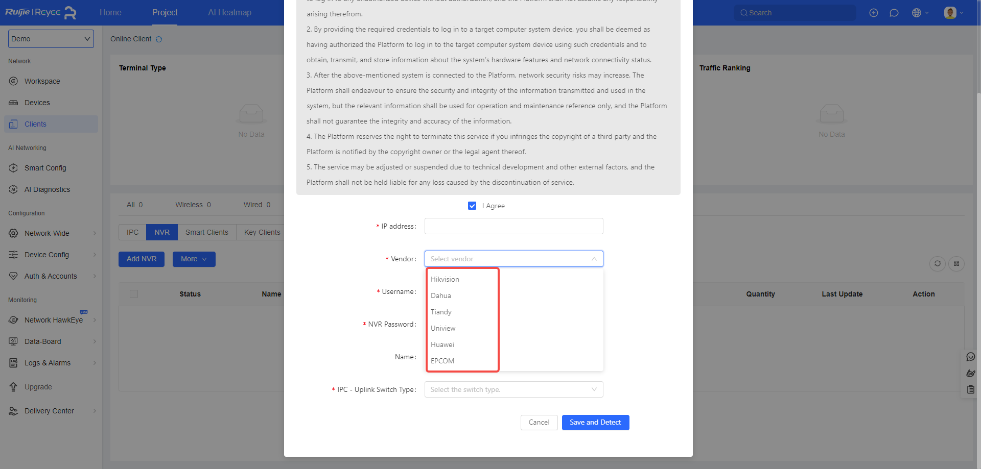

1.Confirm whether the NVR model is supported, at present, only the cameras supported by monitoring manufacturers managed by NVR will be displayed (Hikvision/Dahua/Tiandi Weiye).
2.Make sure the NVR is connected to the switch NVR can communicate with the switch normally.
2. Ensure that the NVR information is correct
3.Delete and re-add it
Troubleshooting Cloud

Hi, User 98113
1. Check if the NVR is from a supported vendor:
2. Check if the NVR is connected to the switch properly, please check if the switch is online on Cloud normally or not, too.
3. Check if the NVR username and password are correct
If the issue still exists, please help to collect the result of the above steps and talk with me again. I would be glad to help you in Community.
