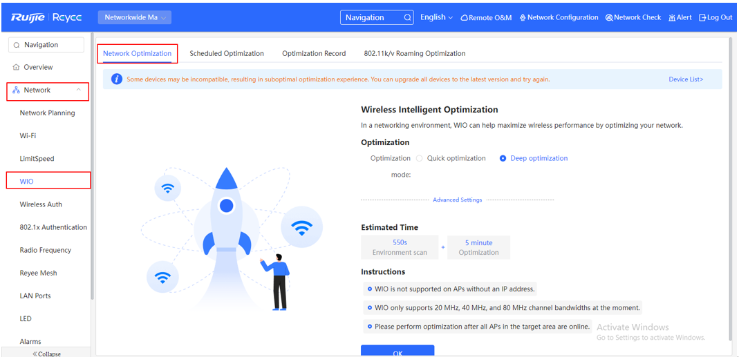

In Network mode, choose Network > WIO, select the optimization mode. Then, click OK to optimize the wireless network.

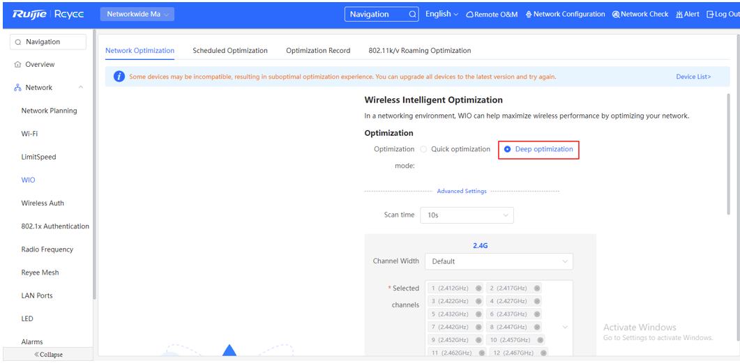

A]Choose Deep optimization. Click to expand Advanced Settings to set the scan time, channel bandwidth and selected channels. Then, click OK.
Scan time: Indicates the time for scanning channels during the optimization.
2.4G&5G
Channel Width: Indicates the channel bandwidth. The channel bandwidth will be calculated by the system if Default is selected.
Selected channels: Indicates the channels to be optimized.

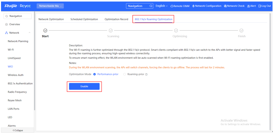

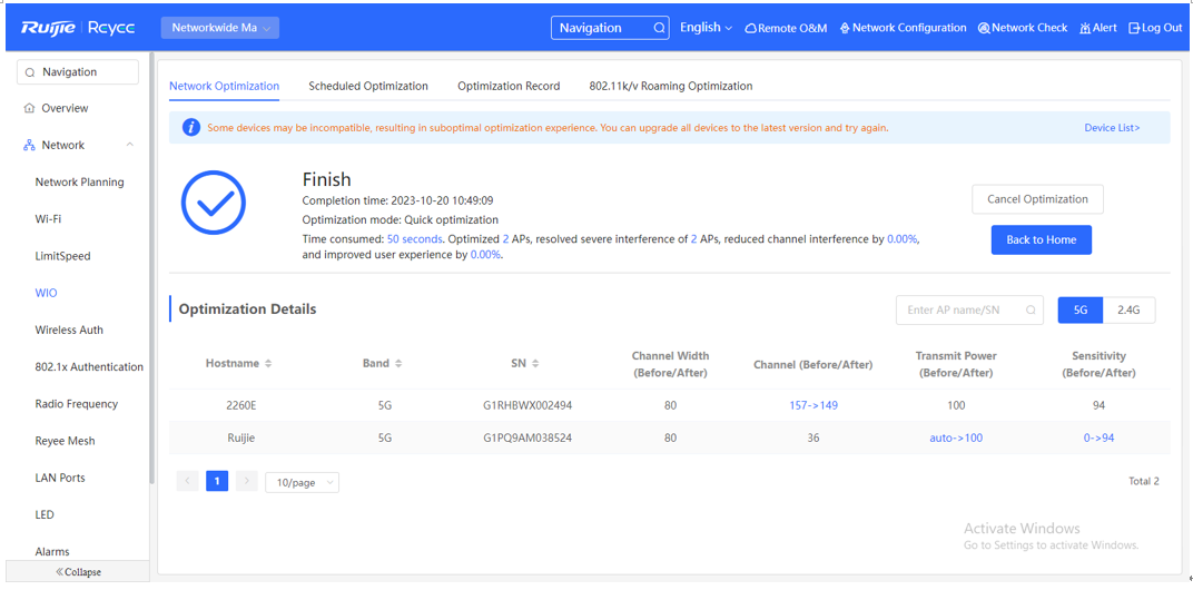

After the optimization starts, please be patient and wait for the optimization to complete. After optimization is completed, you can click Cancel Optimization to restore the optimized RF parameters to their default values. Click Back to home page to perform wireless optimization again.

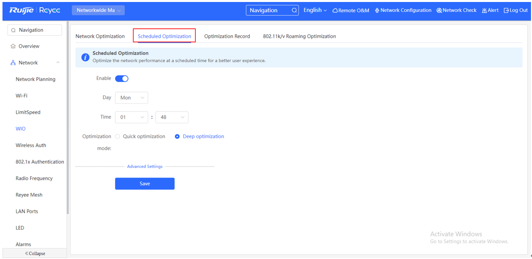

You are advised to set a scheduled task to optimize the wireless network in the early hours of the morning or when the network is idle.

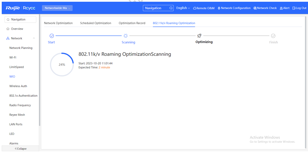

<span style=""">Performance-prior: Maximum negotiation speed is preferentially guaranteed but connection stability may be affected.
</span>
Roaming-prior: Connection stability is preferentially guaranteed but maximum negotiation speed may be reduced.
Notes:
During the WLAN environment scanning, the APs will switch channels, forcing the clients to go offline. The process will last for 2minutes.
