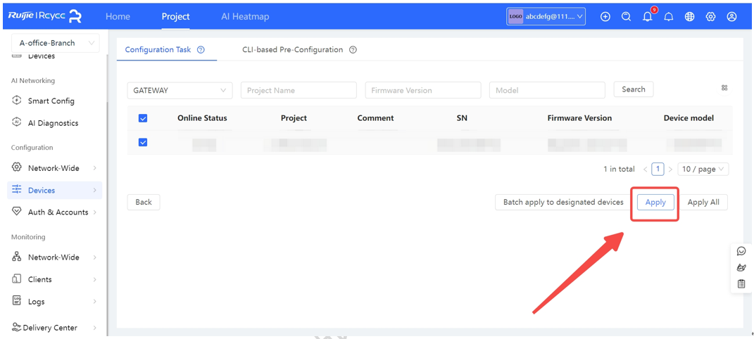

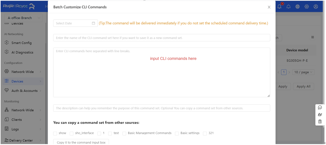

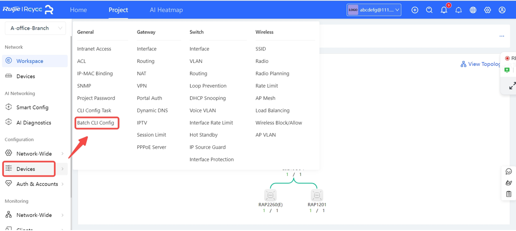

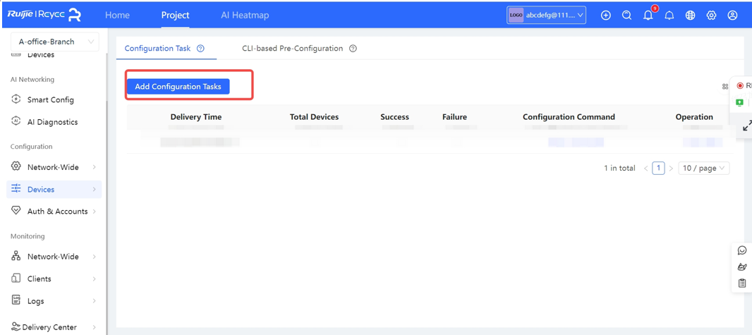

For Ruijie APs managed on cloud, you can change all AP Wi-Fi channels using CLI in batch:
CLI commands:
2.4 Ghz
Hostname(config)# interface dot11radio 1/0
Hostname(config-if-Dot11radio 1/0)# channel 11 (youcan designate the channel)
Hostname#wr
Hostname#end
5Ghz
Hostname(config)# interface dot11radio 2/0
Hostname(config-if-Dot11radio 1/0)# channel 149(you can designate the channel)
Hostname#wr
Hostname#end

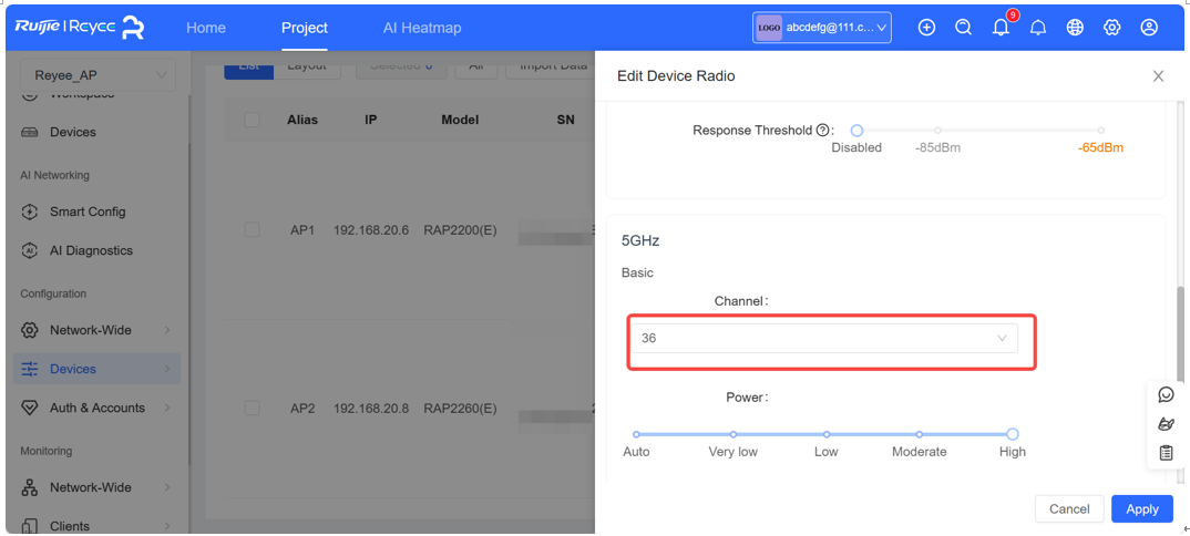

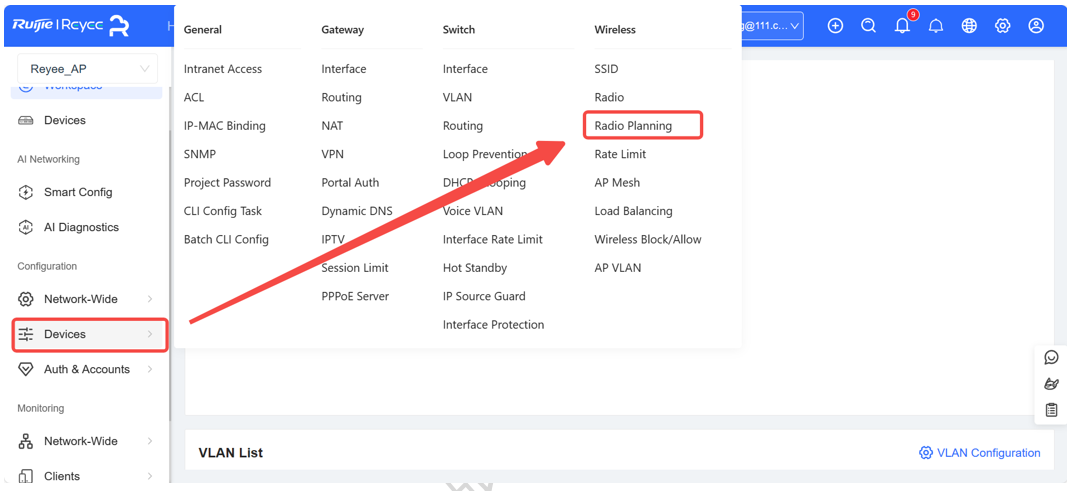

For Reyee APs managed on cloud, you can change AP Wi-Fi channel on cloud:
1. Enter the radio planning on cloud
3. Change your APs Wi-Fi channel here

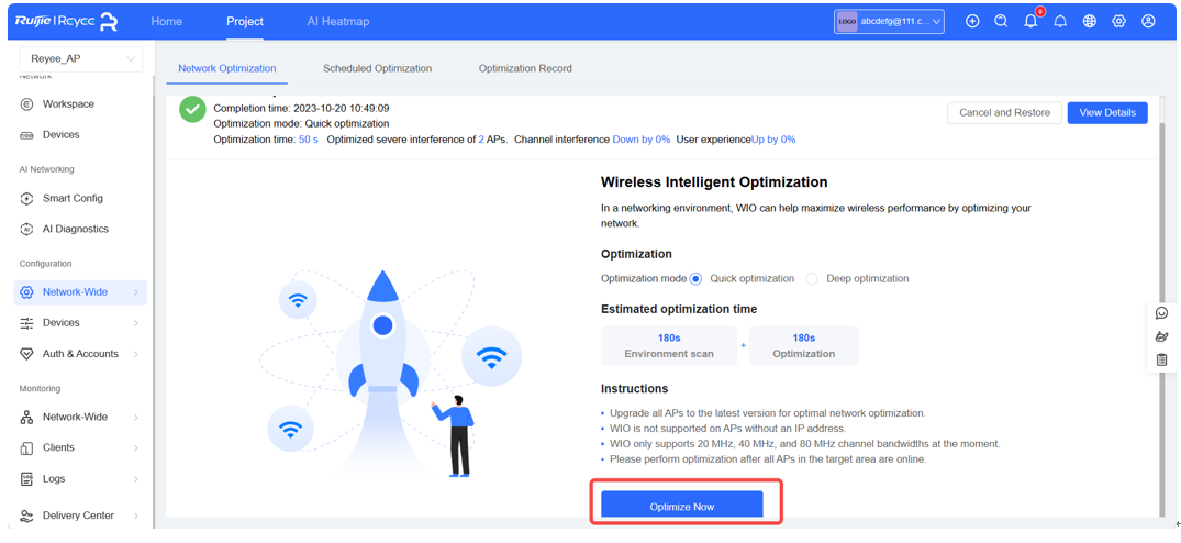

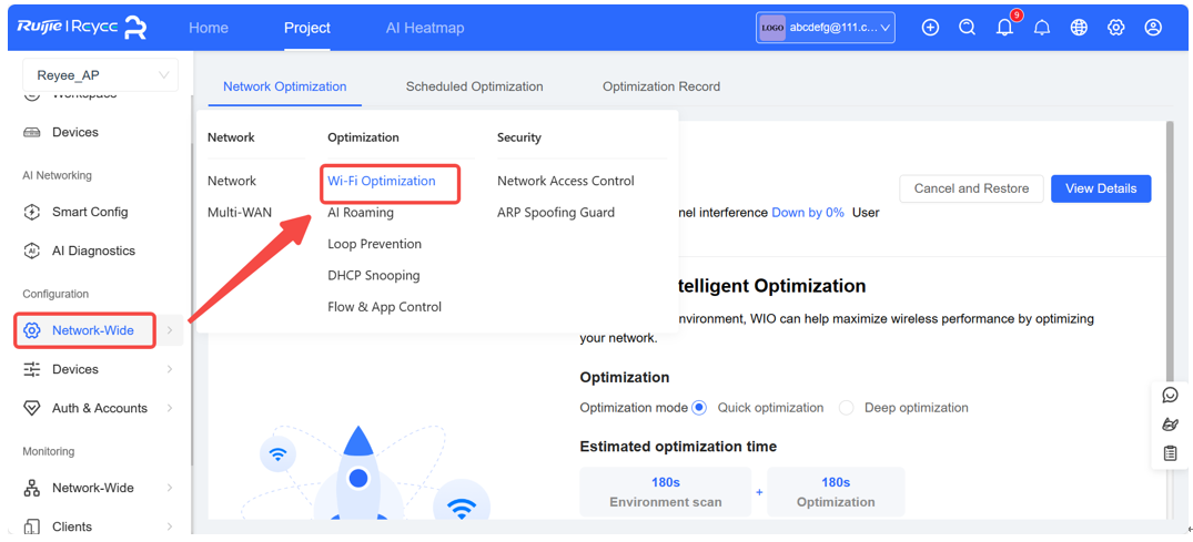

<span style=""">4. You can also conduct Wi-Fi optimization from here. Cloud would help organize wireless environment analysis and help adjust all your APs Wi-Fi channels automatically to help reduce your wireless network interference:
