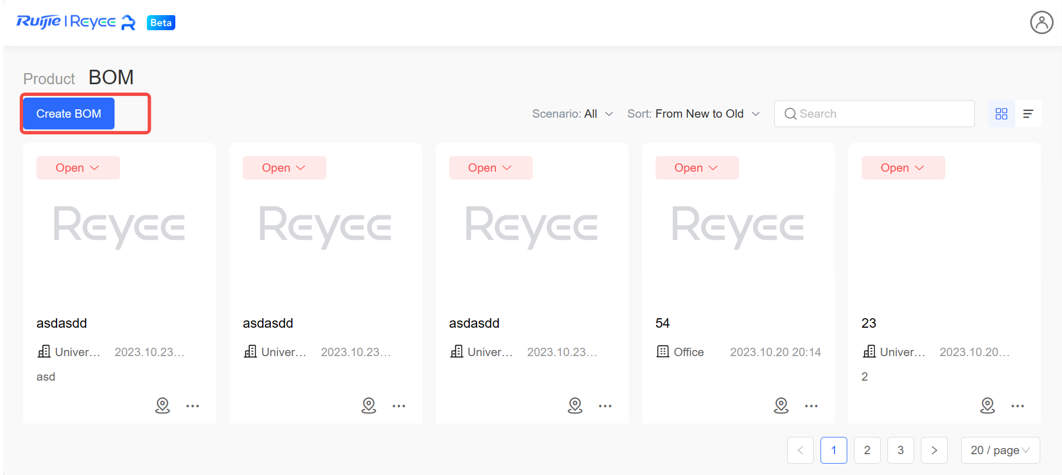

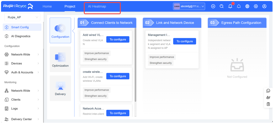

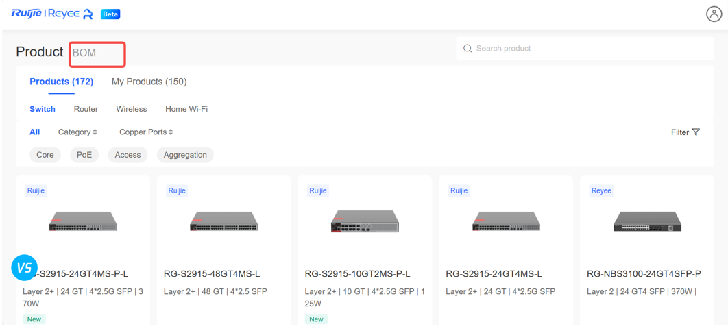

1. Login to your account and click AI heatmap here
2. Then click the BOM button

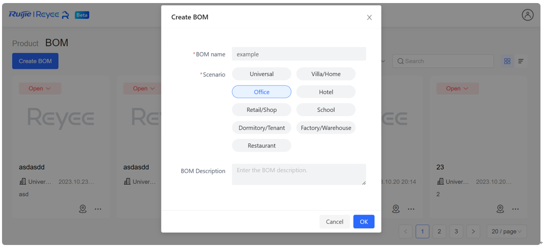

3. Click create BOM

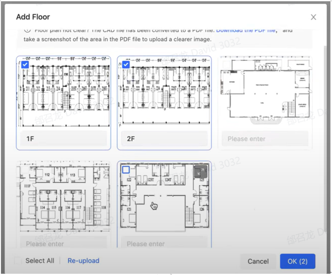

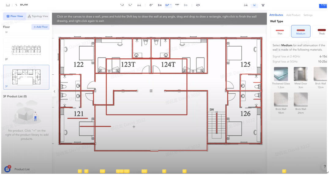

4. Input BOM name and select scenario

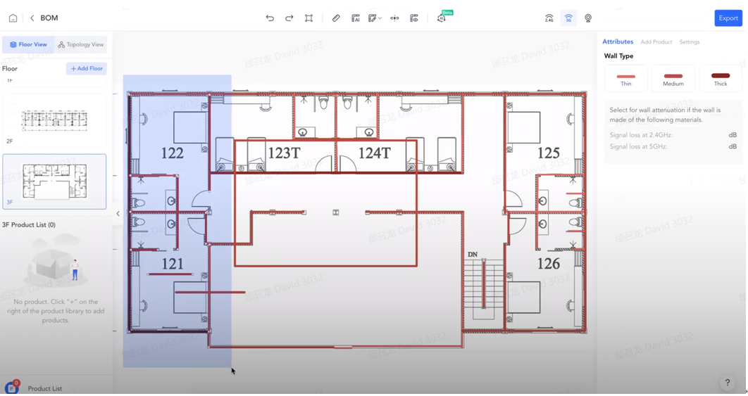

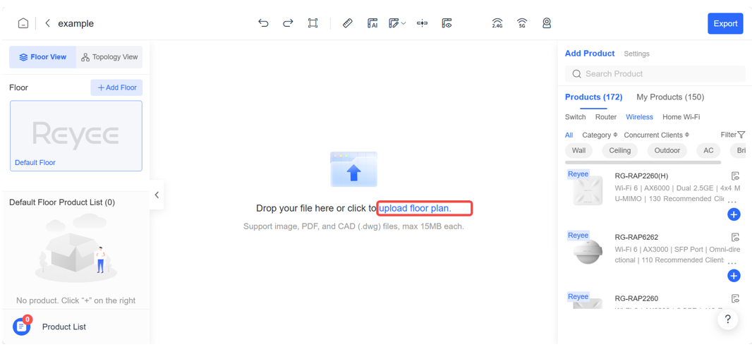

5. Upload your floor plan file (PDF, CAD etc)
6. Edit your uploaded map

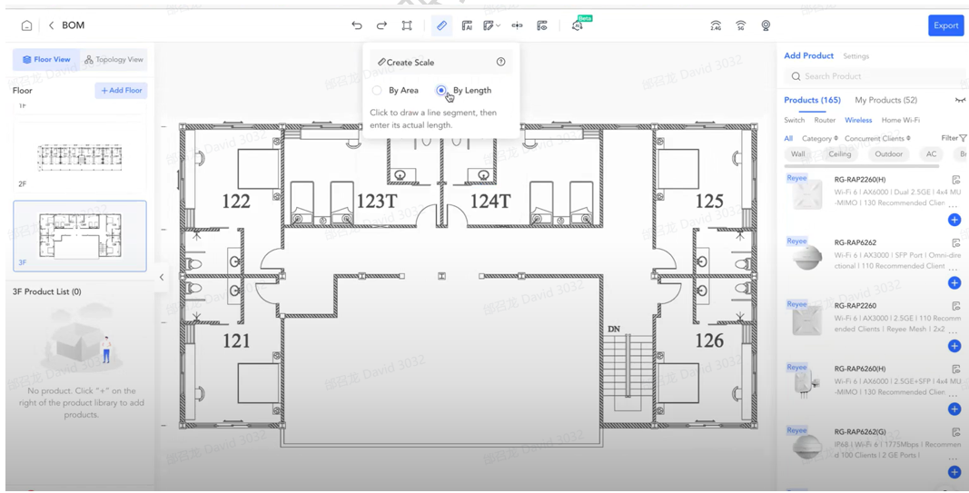

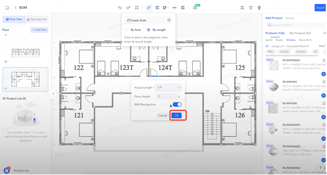

7. Edit your map's scale

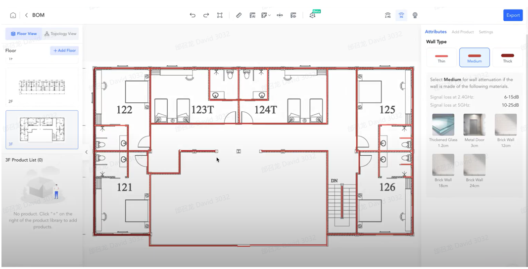

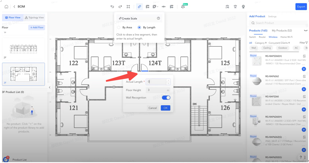

8. Draw a line standing for wall and edit its length

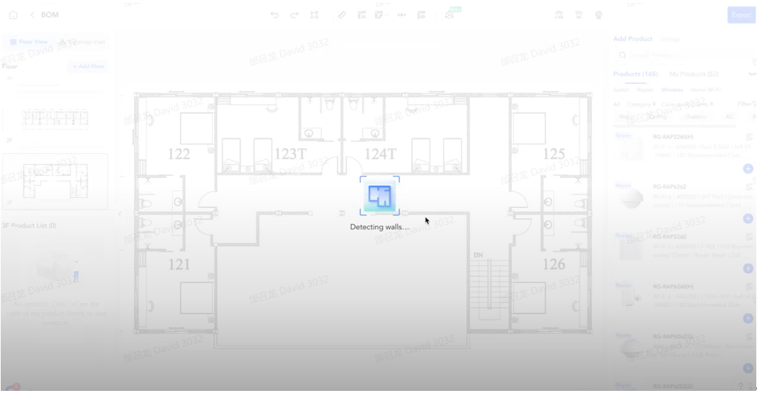

9. Click OK and start detecting the wall
10. AI heatmap would help generate a map with walls automatically and you can help modify the generated map

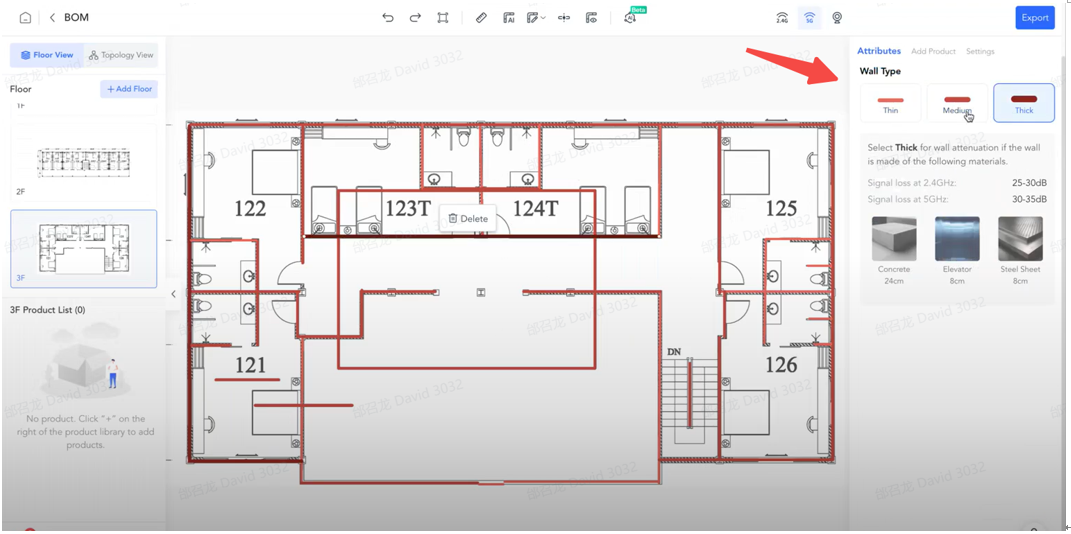

11. Use the left mouse button to draw box-shaped walls, and the right mouse button to cancel the drawing.
12. Edit wall shape here
13. Press Ctrl and use the mouse to batch-select walls.

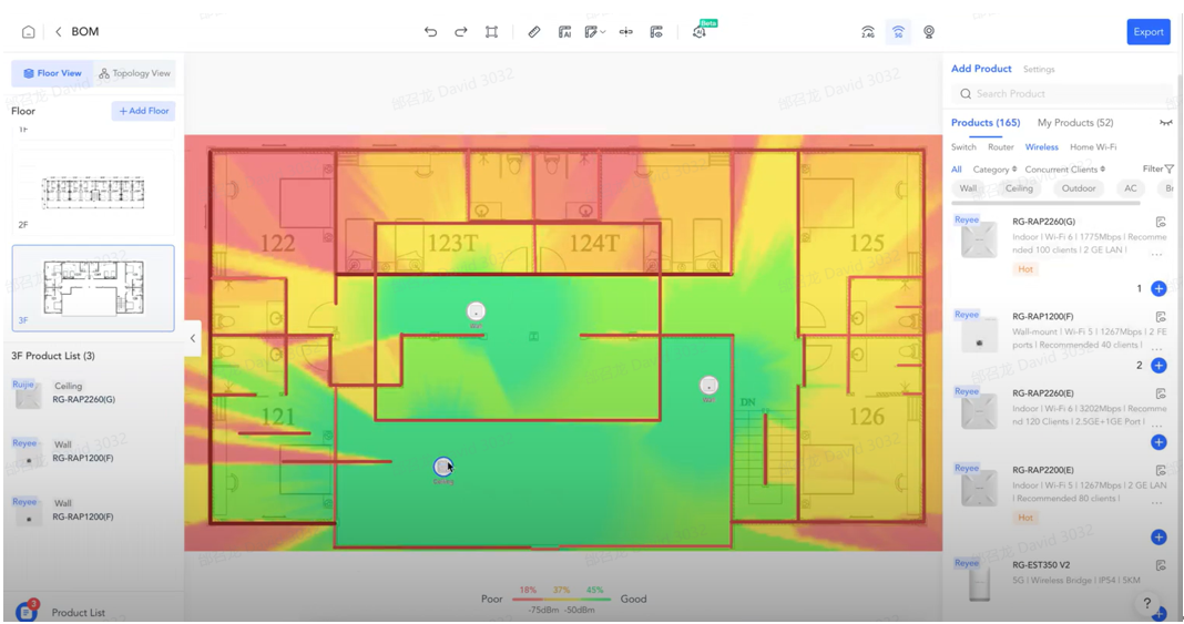

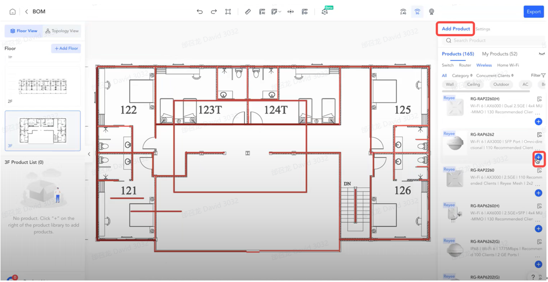

14. After drawing your maps, then we could add products to complete our heatmap
15. We can draw products to where they are at

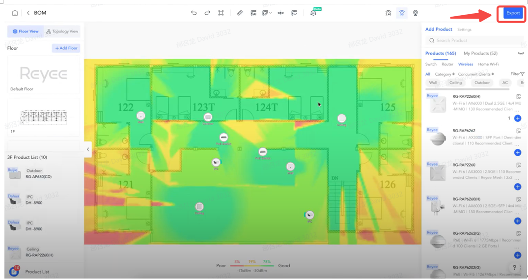

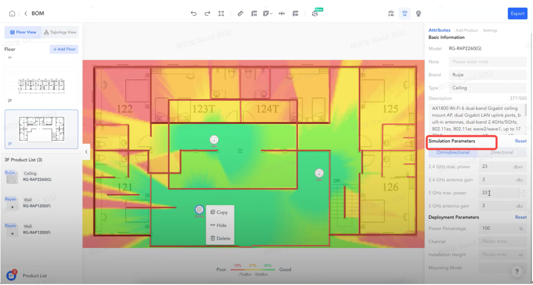

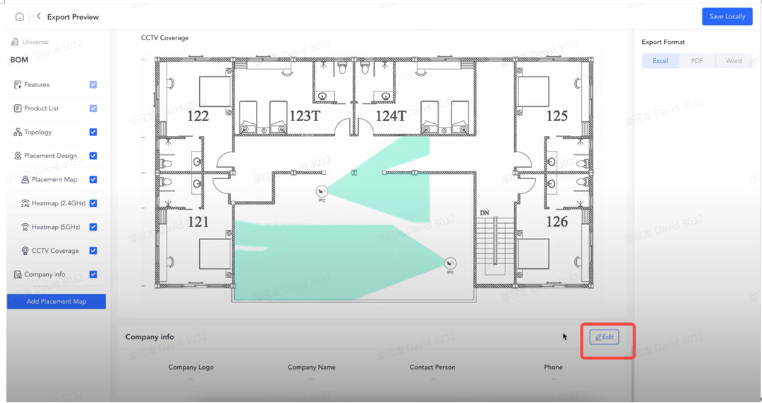

16. Edit simulation parameters to determine the optimal ones.

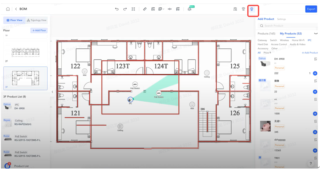

17. We can check 2.4G and 5G signals here
18. We can check our cameras' coverage area here

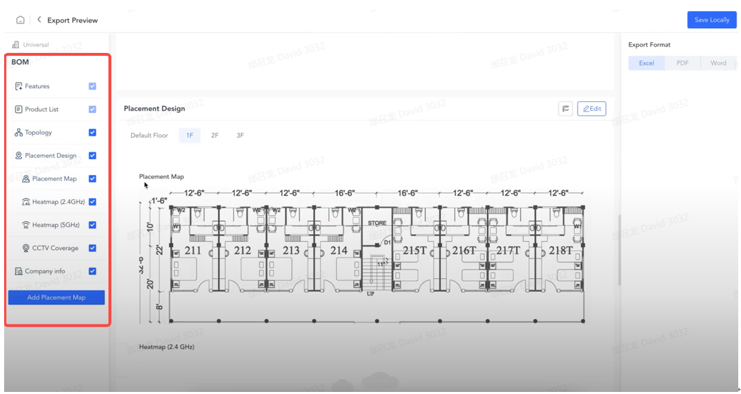

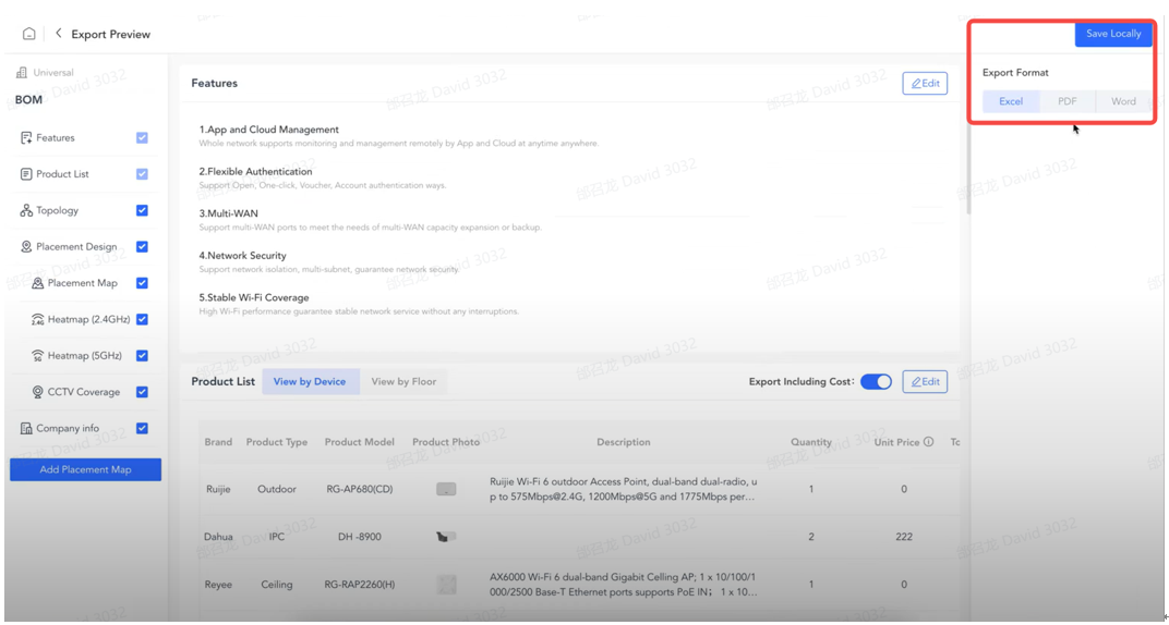

19. Click export and generate heatmap file
20. You can edit this column to choose the information you'd like to generate
21. Click edit here to edit your company information
22. Save locally via three file types

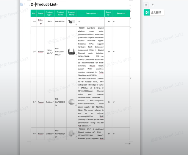

23. You can check all the information in the downloaded file based on your layout and configuration.
