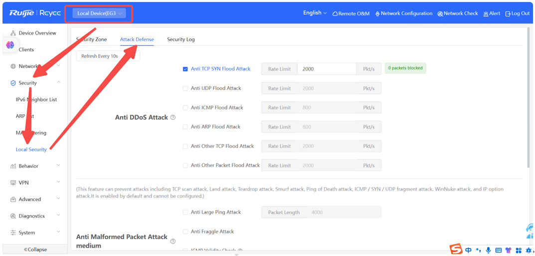

1. Create an eweb interface on the cloud or enter its web interface locally.
2. Choose Local Device > Security > Local Protection or Security Domain> Attack Defense

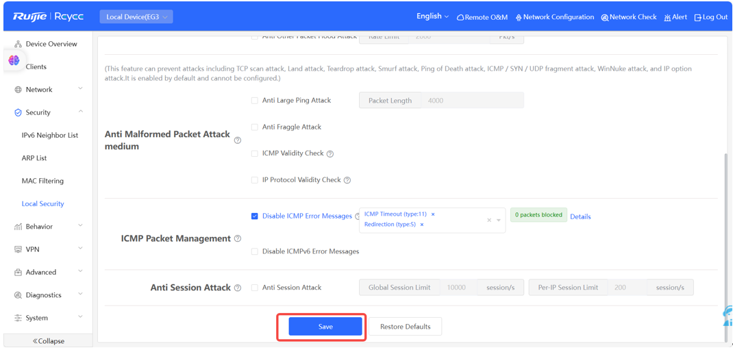

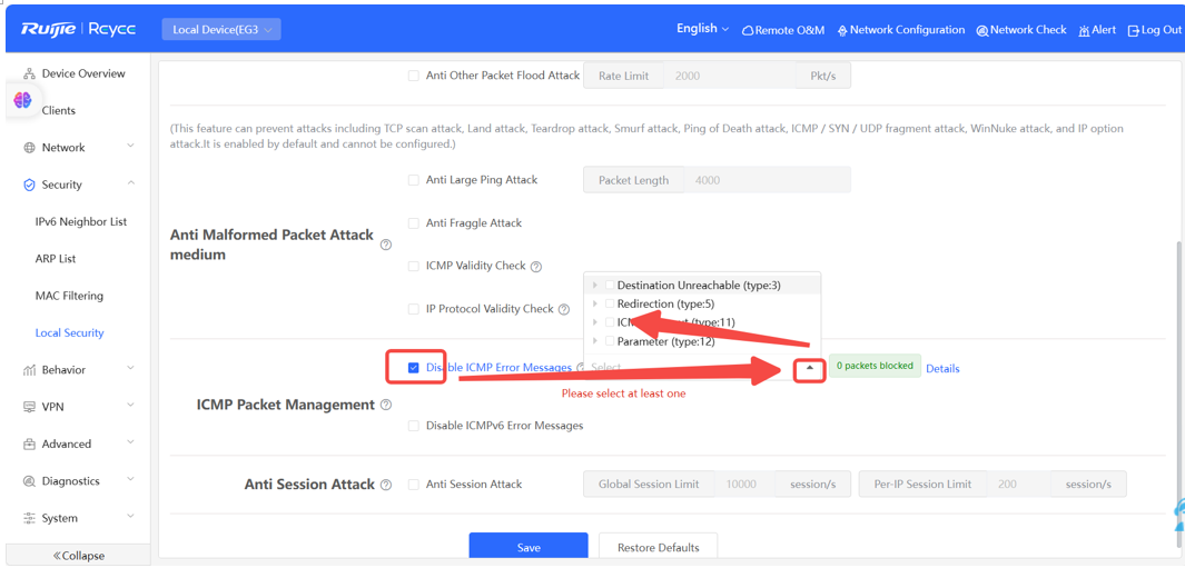

3. Select the packet types that are prohibited from being sent by the device. Select at least one packet type.
Enable Disable ICMP Error Messages. You can select Destination Unreachable, Redirection, ICMP Timeout and Parameter.
Enable Disable ICMPv6 Error Message. You can select Destination Unreachable, Datagram too Big, Time Exceeded, and Parameter Problem.
4. Finally, click the save button at the bottom of this page to save the configuration. You can also restore it to the default settings here too.
