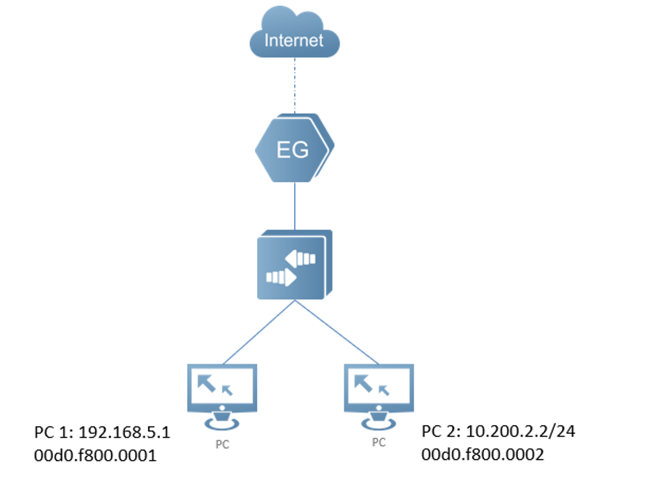

1. Network requirements
Only the bound IP addresses and MAC addresses can access external networks.
2.Topology
3. Configuration tips
Bind IP and MAC addresses globally.
Configure exceptional interfaces (no binding restrictions)
Enable the address-bind function
By default, IP-MAC address binding is disabled.
4. Configuration steps
Ruijie>enable
Ruijie#configure terminal
Ruijie(config)#address-bind address-bind192.168.5.1 00d0.f800.0001   ------> Configure the binding relationship between IP addresses and MAC addresses
Ruijie(config)#address-bind uplink G0/24  ------>Configuring an Exception Port for address Binding (Uplink Port)
Ruijie(config)#address-bind install   ------>makethe binding of IP and MAC addresses takes effect
Ruijie(config)#end
Ruijie#write     ------>save configuration
