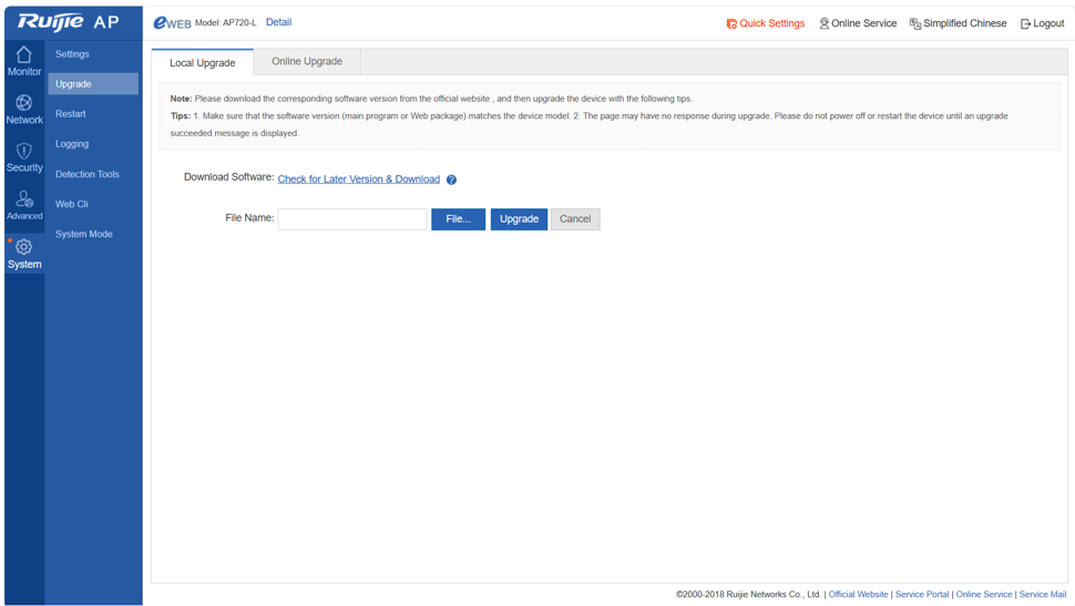

1. Take the AP720-L as an example, log in to the web interface of the device and click ’System --->’Upgrade --->’Local Upgrade
Click 'Upgrade'
<span style=""">Note: The device will be restarted after the device upgrade is completed. Please do not upgrade during business operation, and do not power off the device when upgrading, otherwise the version will be lost.
