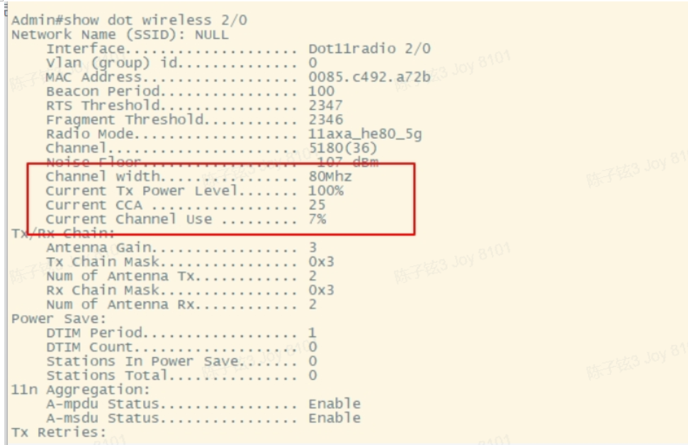

How to check the current channel utilization of Ruijie AP in fit mode through CLI? Reply
4054 0 2023-12-19 16:51:03
#show dot wireless 2/0 (1/0 is 2.4G , 2/0 is 5G)
RG-RAP6262(G)
Configuration Wireless
