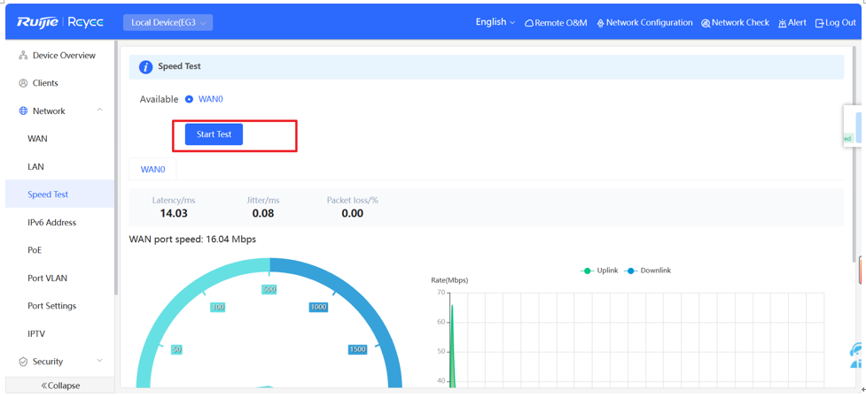

You can test wan speed on EG305GH-P-E as follows:

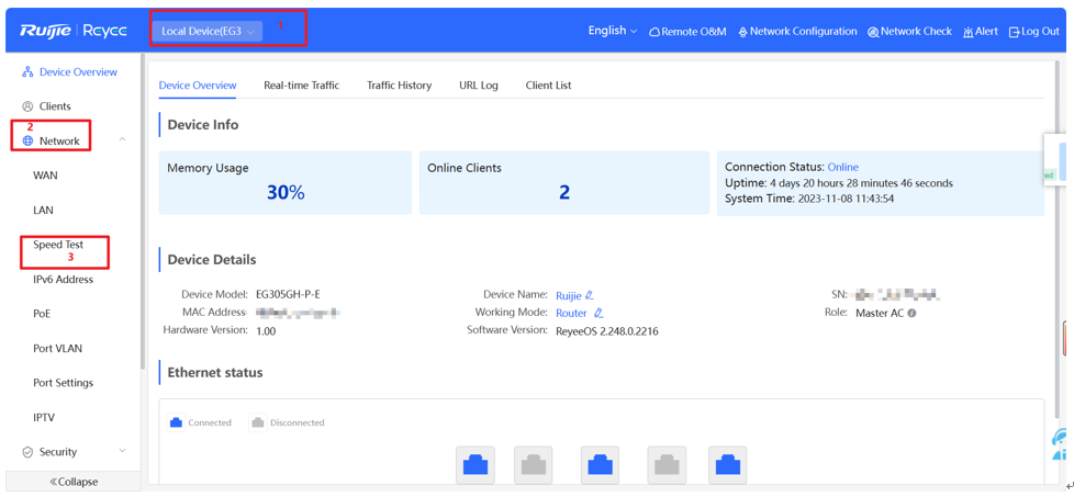

1. Login EG305GH-P-E, choose Local Device---Network---Speed test
2.Click Start Test

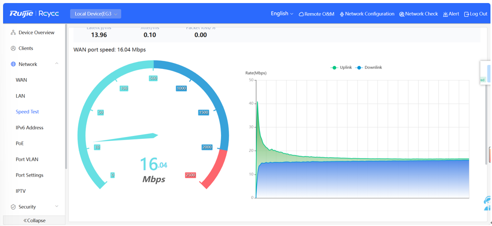

3. Check the speed test result
EG305GH-P-E

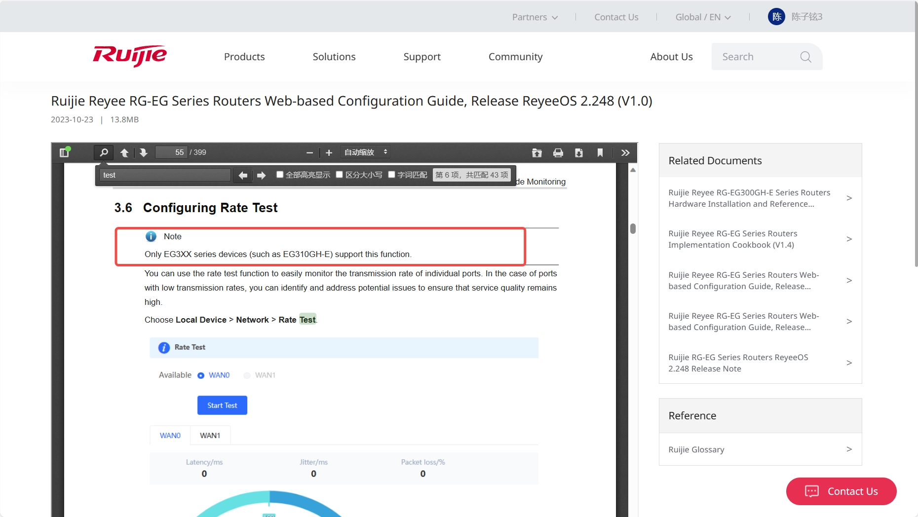

Does the 200 series also get this?
0 2023-12-20 21:34:40 View all replies
Rasmus replied at 2023-12-20 21:24
EG200 series not support this.
0 2023-12-20 21:36:14 View all replies
GTAC-Micca replied at 2023-12-20 21:34
is no plans to add this to the other series?
0 2023-12-20 21:48:27 View all replies
Rasmus replied at 2023-12-20 21:36
Currently not support. If you want, I can help you feed back to R&D
