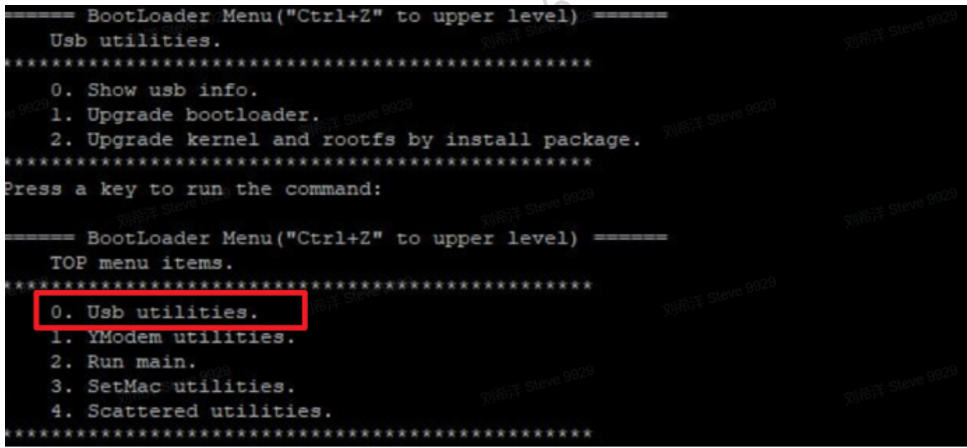

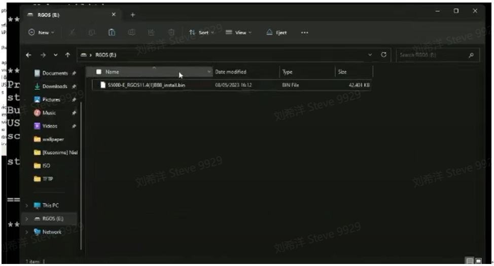

1.First, you need to insert the USB flash drive into the S5000 and import the version into it. Then connect to the switch through the console, you can refer to this link:【New reminder】How to use console cable to login ruijie device? - Switch - ruijienetworks
2.Restart the switch, hold down ctrl as prompted and press C repeatedly to enter the boot layer, Press a key to run the command: 0---->choose 0 Usb utilities.

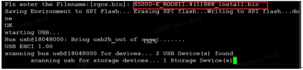

>choose]4. You can view the files on the USB flash drive and input them to the BOOT screen. The complete file name must be input to the BOOT screen.

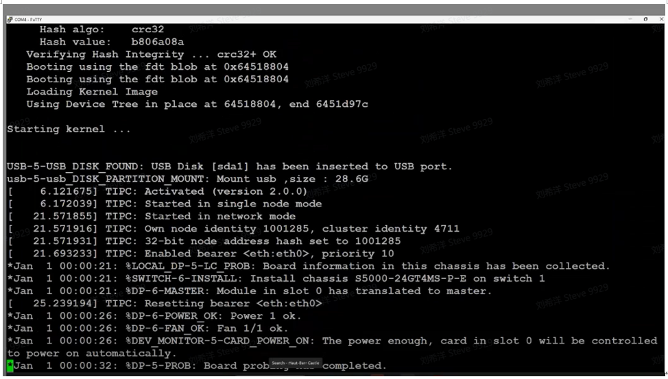

<span style=""">5. Wait for 3 to 5mins to view the result. You can see that the kernel image is started normally.
