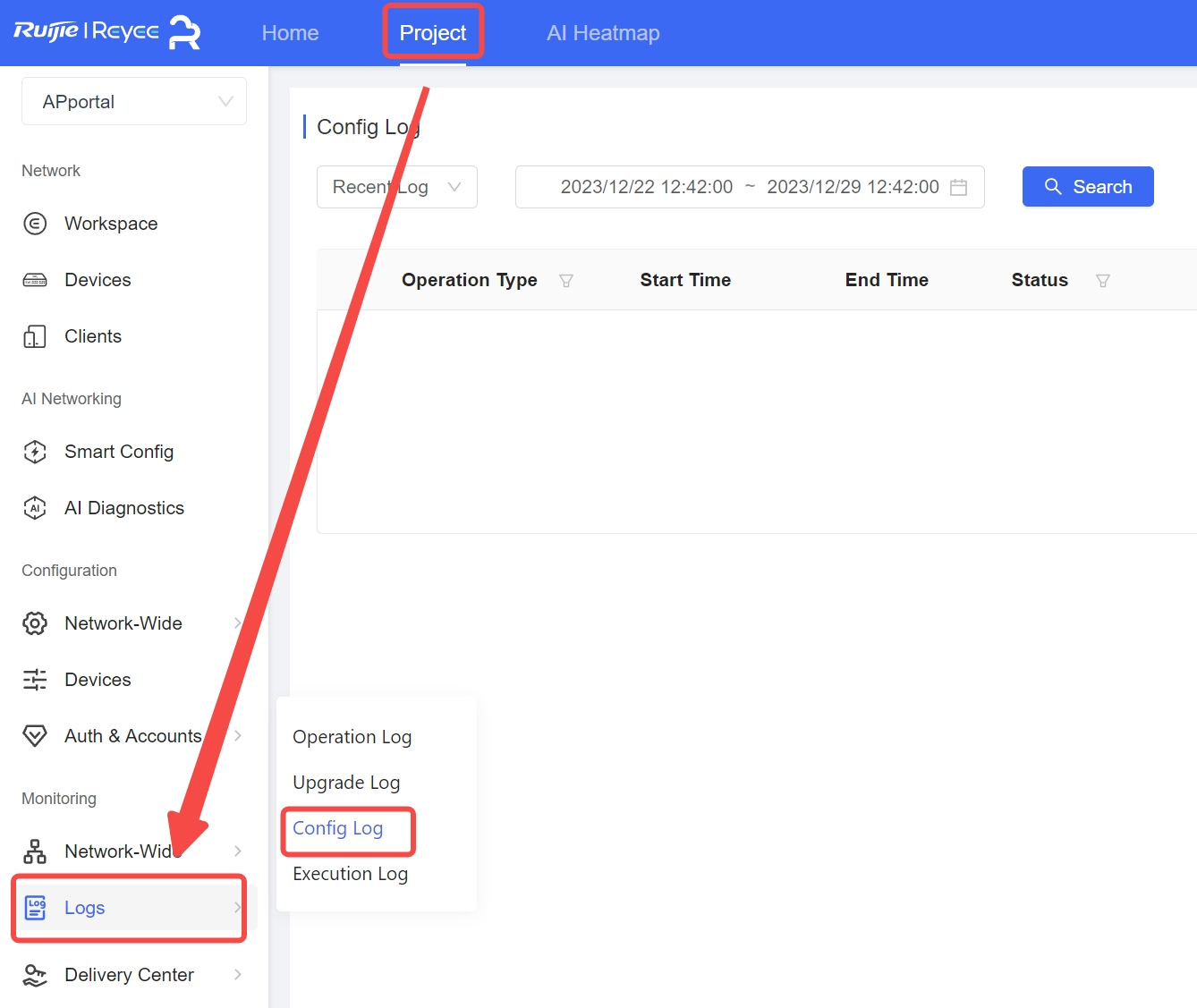

Dear User 87329,
If you are using the new Cloud UI, you may check the config logs inside the project:

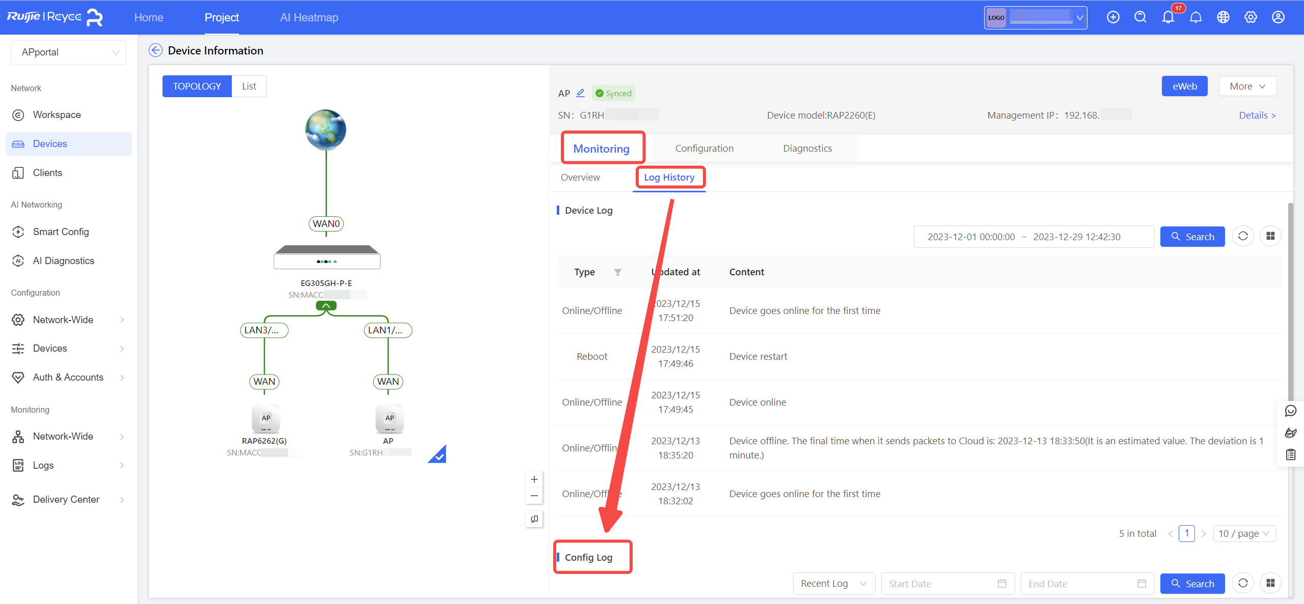

You may also check the config logs on each single device in its Device Information page (access by clicking Device SN):
