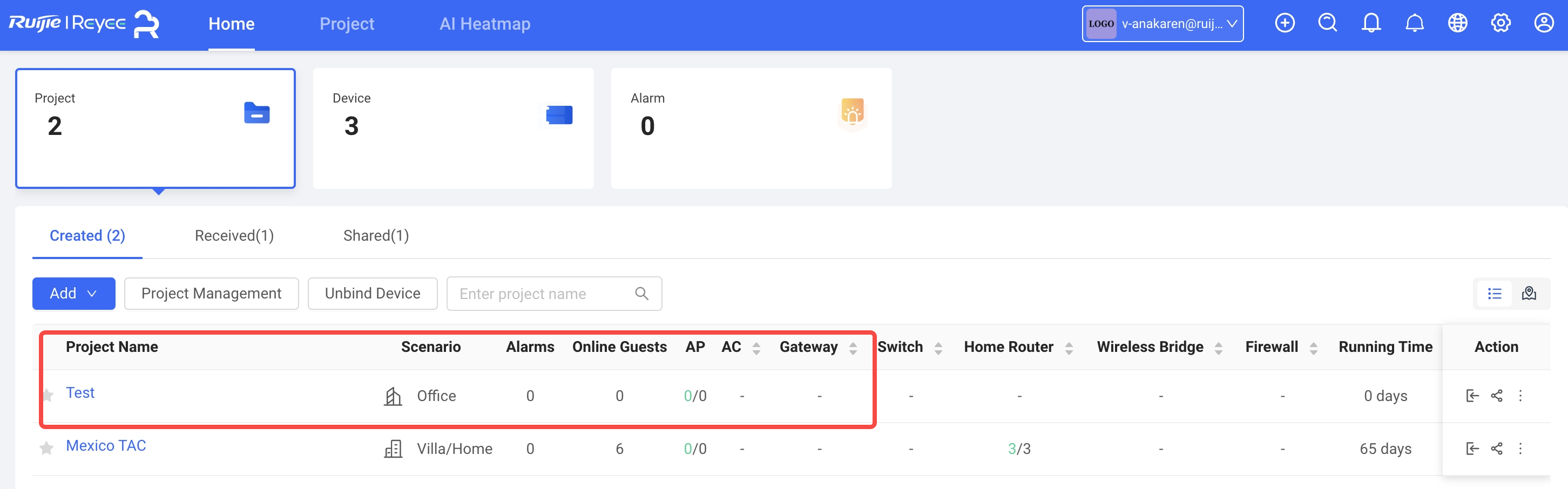

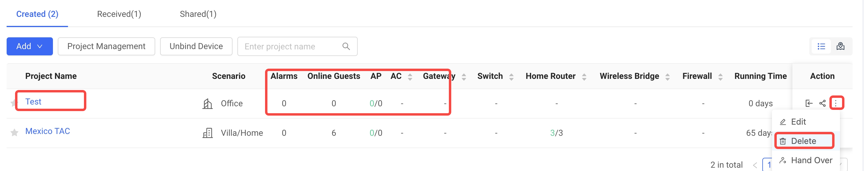

To able to delete  the empty projects that have been created in the accounts, you must follow the following  steps.
In the project that is empty, go to the 'Action' colum and select the three dots.
Then choose 'Delete' to remove and disappear from the list.

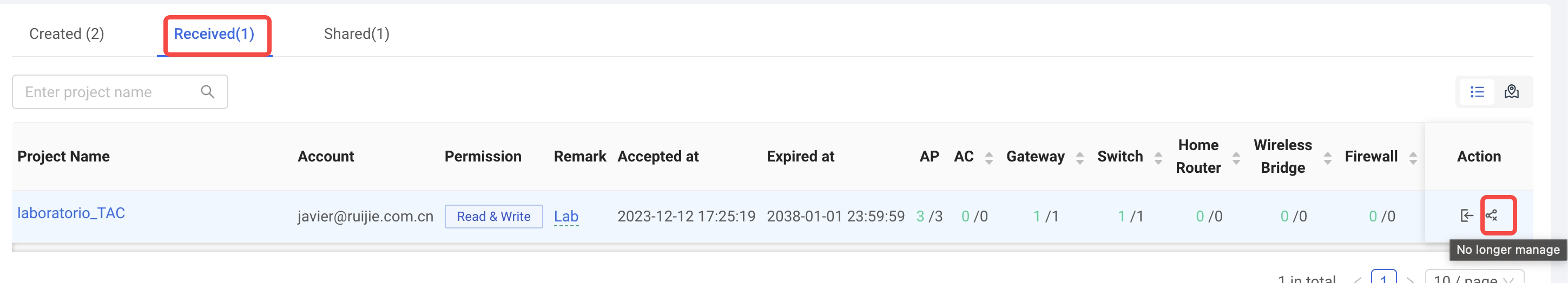

To delate the project that were received, select 'Received', go to the 'Action' colum,and select the 'share'  icon whit an 'x'.
Then   the  project will be remobved from list.

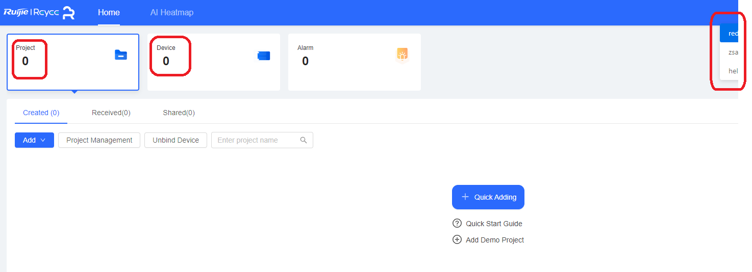

As seen here. There is nothing inside. In this picture the first project named red is selected but it's empty.
zsa is also empty. Only project hel has a device in it.

Apparently if it's an empty project the only choice is to delete the account and re-register to the project as a new account.
I fixed this issue by exactly doing the above.
Delete old account.
Reregister to project.
Thank you for the help.
