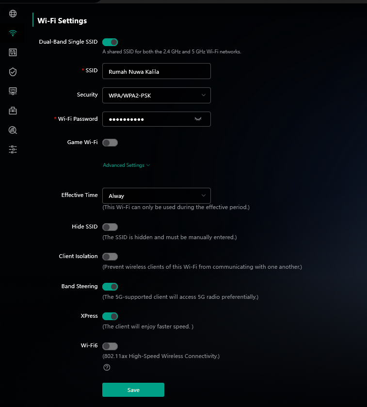

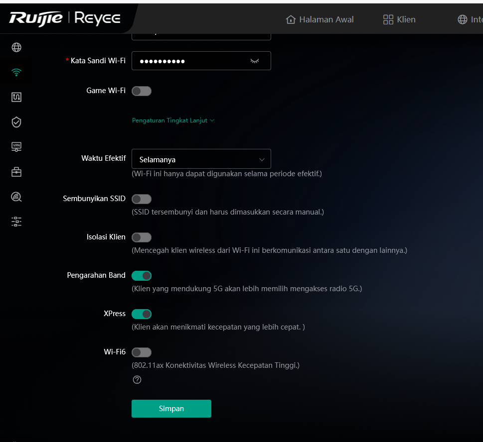

i have enable dual-band SSID. this my wifi setting
i don't checked wi-fi6 because i don't have device support it now.

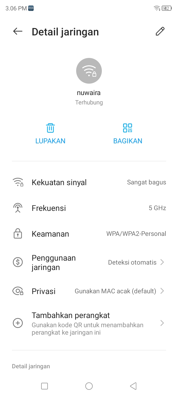

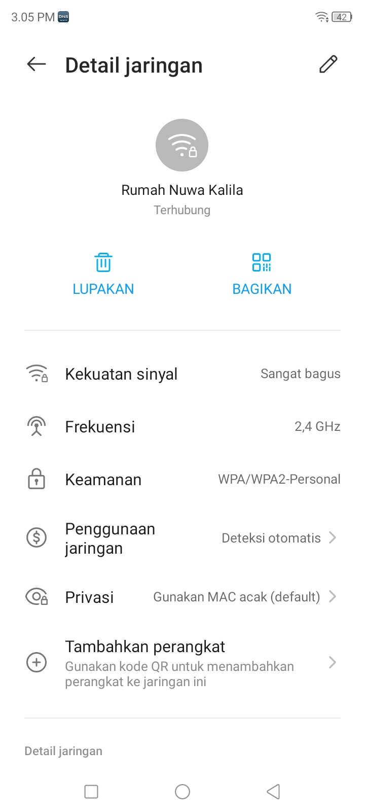

this my wifi ZTE blade a72 phone status when used RG-EW3000gx pro. Used 2,4ghz band.

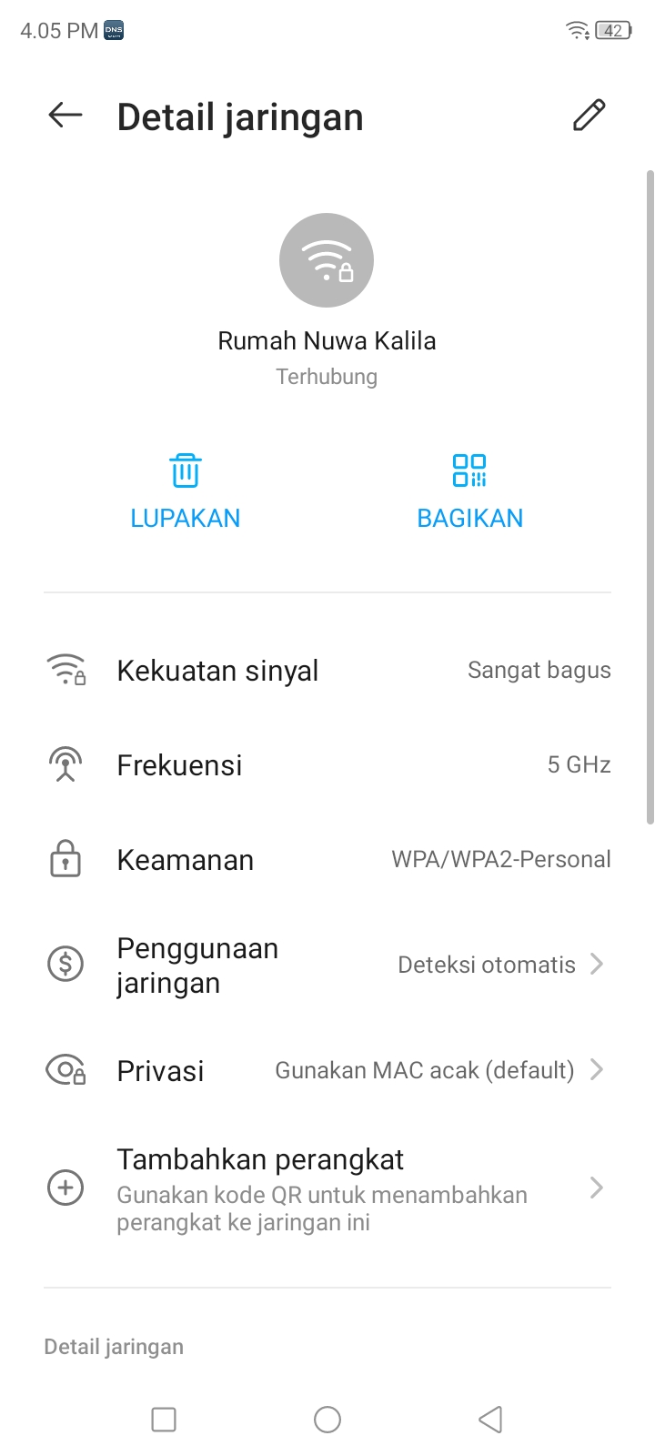

this my zte blade a72 wifi status when used my ISP router. Used 5ghz band.

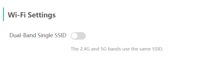

You may try disable dual-band SSID so that 2.4G and 5G SSIDs will be separated, and you can connect your devices to the 5G-only SSID.

i have try it. But wifi with 5ghz from rg ew-3000gx pro not show up in my zte blade a72. i buy rg ew-3000gx pro for upgrade my wifi router from ISP.

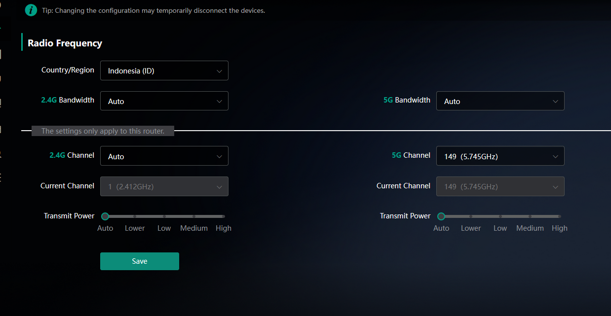

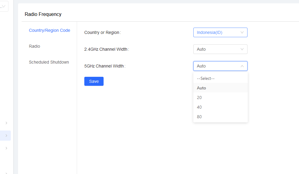

Please check if you have set the correct country code in the Radio Frequency settings, and which 5G channel are you using at the moment? Can you try to change it to a common channel like 149 and test again?

this my radio setting in ruijie cloud

it's worked. i change 5ghz to channel 149 and all my phone get 5ghz band. thank you

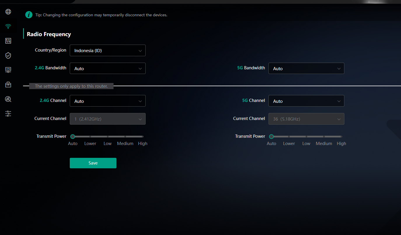

The automatically selected channel 36 is not supported in Indonesia and that caused the issue. May I please confirm what is the current firmware of your EW3000GX Pro? If it's not the latest version which is ReyeeOS 1.301, please upgrade it so that when you change the channel back to Auto, it can select the correct channel.
