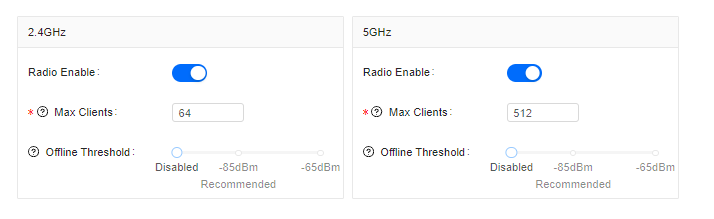

I am using 2260g , it is showing me that in 2.4Ghz channel the clients are 64 and in 5Ghz it is 512,so what is the max amount of clients i can enter in 2.4Ghz Channel? Following is the picture attached:

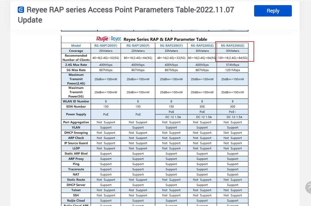

Please refer to this link: https://community.ruijienetworks.com/forum.php?mod=viewthread&tid=1824&page=1&extra=#pid2850
Recommended 100 users, 16(2.4G)+84(5G)

Recommended No. of Manageable STA: 16(2.4G)+84(5G)
By recommended users, our device can guarantee the normal Internet access of these users at the same time.
Maximum No. of Manageable STA: 64(2.4G)+512(5G)
The maximum number of users means that our device can support the maximum number of users to connect, but it cannot guarantee that all users can access internet at the same time

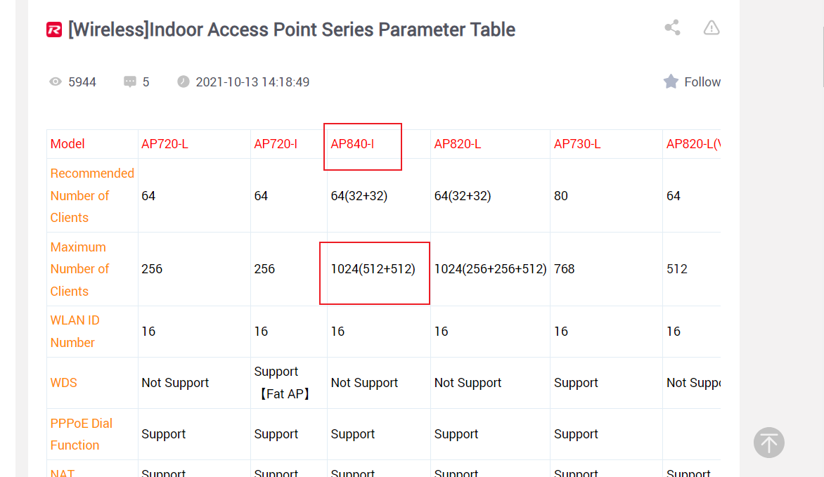

Reyee Series AP seems not support. If you need, you can refer to Ruijie AP series, like AP840-I
https://community.ruijienetworks.com/forum.php?mod=viewthread&tid=1945&highlight=Para

If you need the number to be 512 not for technical reasons but just to fulfill a tender, go for Ruijie AP8XX APs.
Technically those support many clients. Those have some other advantages over Reyee APs as well.
