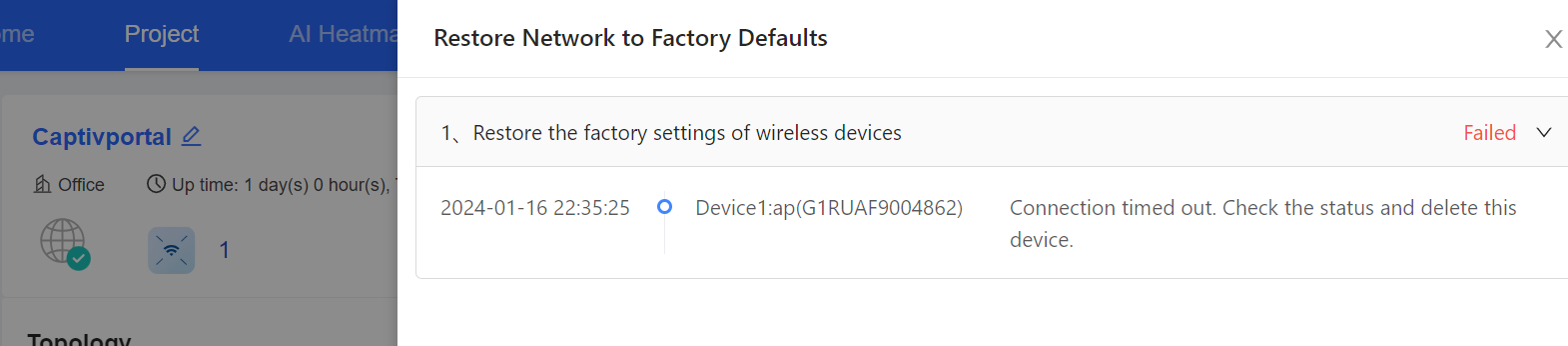

Factory reset of project by web cloud, reset's only other devices but not this one.

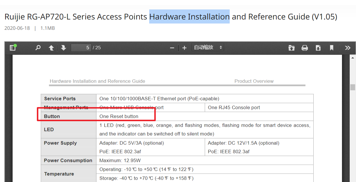

Supplement: If the above does not include the model you need to obtain
You can access our website official to check it:https://www.ruijienetworks.com/
Query: Product Manual - Select model - Hardware Installation
- Search for reset (if displayed, reset recovery is supported)
