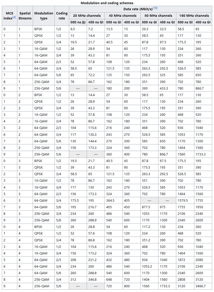

The above result is the dazzling rates, as shown in the following table:
