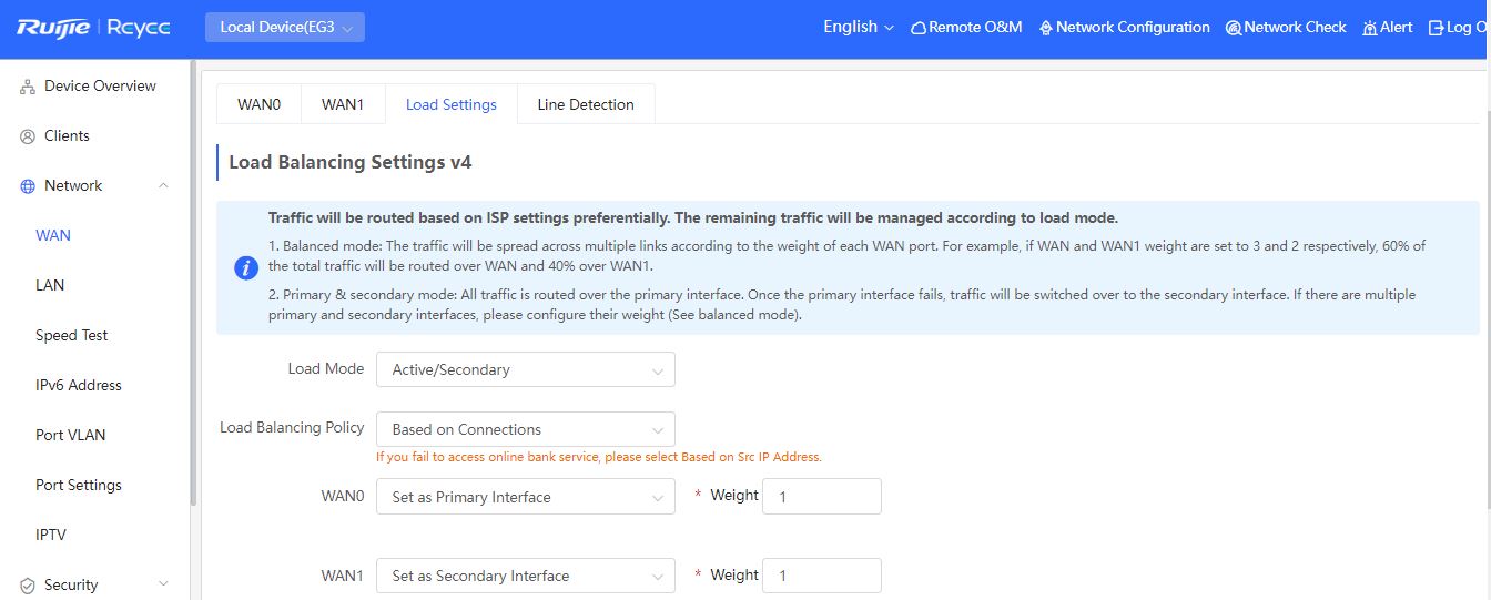

Hello Support
I want to setup Internet Failover on Reyee EG Series Routers. I have 2x Internet connections. Primary Fibre line, Secondary LTE
So if Primary Fibre line fails the Secondary LTE needs to connect.  And When Primary Fibre line is back online then Secondary LTE must disconnect
Please advise me how to setup?
RG-EG105G V2
Router Configuration Learning material
0 2024-1-25 18:13:21 View all replies
0 2024-1-25 18:42:39 View all replies

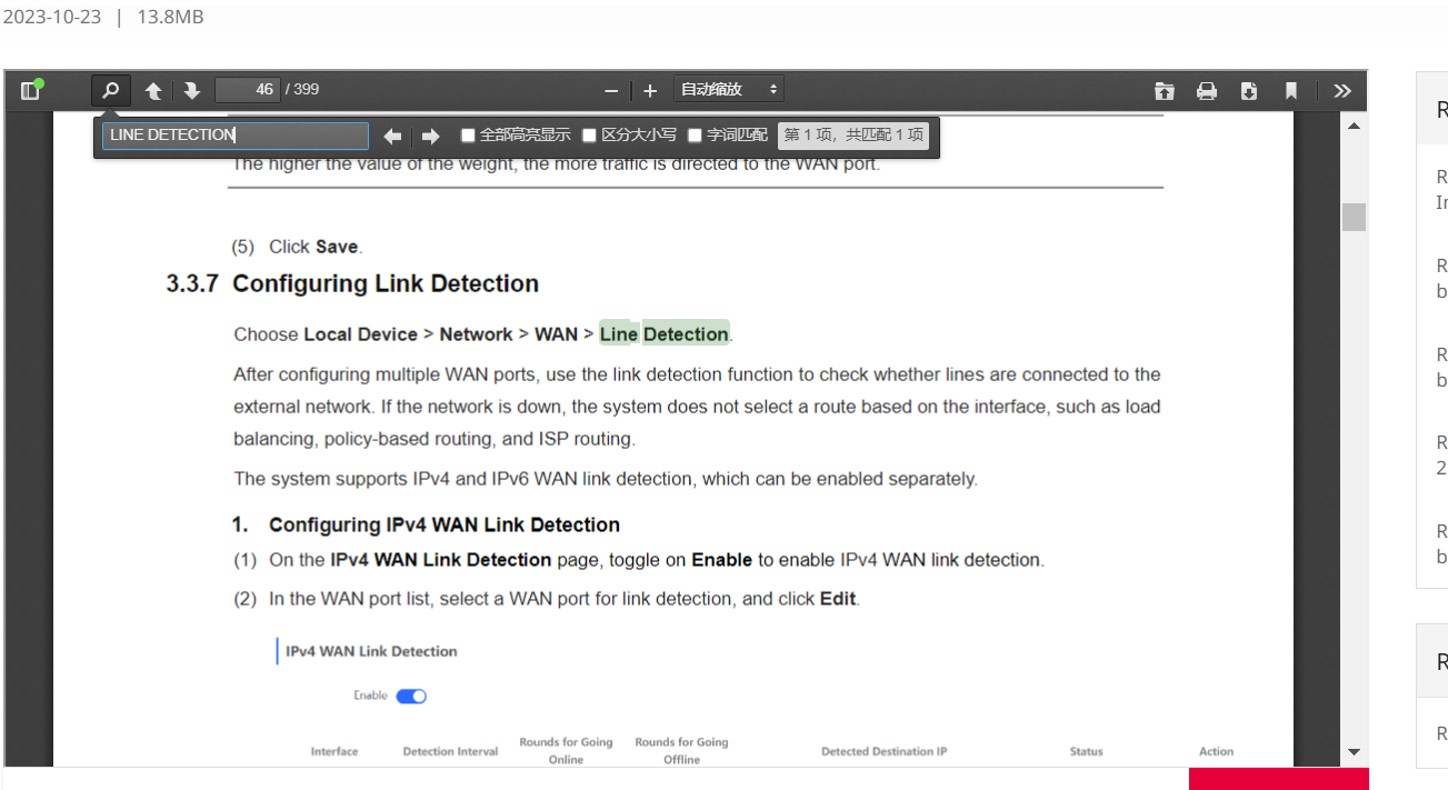

GTAC-Stella replied at 2024-1-25 18:13
plz refer to https://www.ruijienetworks.com/resources/preview/ruijie-reyee-rg-eg-series-routers-web- ...

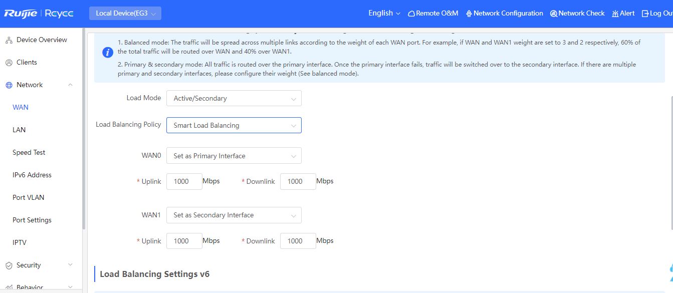

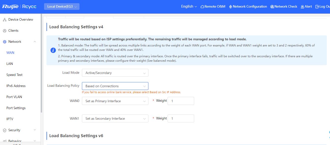

Hi Stella
Documentation doesnt have everything - Missing information
So must I setup like this - 2 Options
Active\Secondary \ Based on Connection
And what must Weight be? ( I see it is default set 1 \ 1)
Or
Active\Secondary \ Smart Load Balancing
