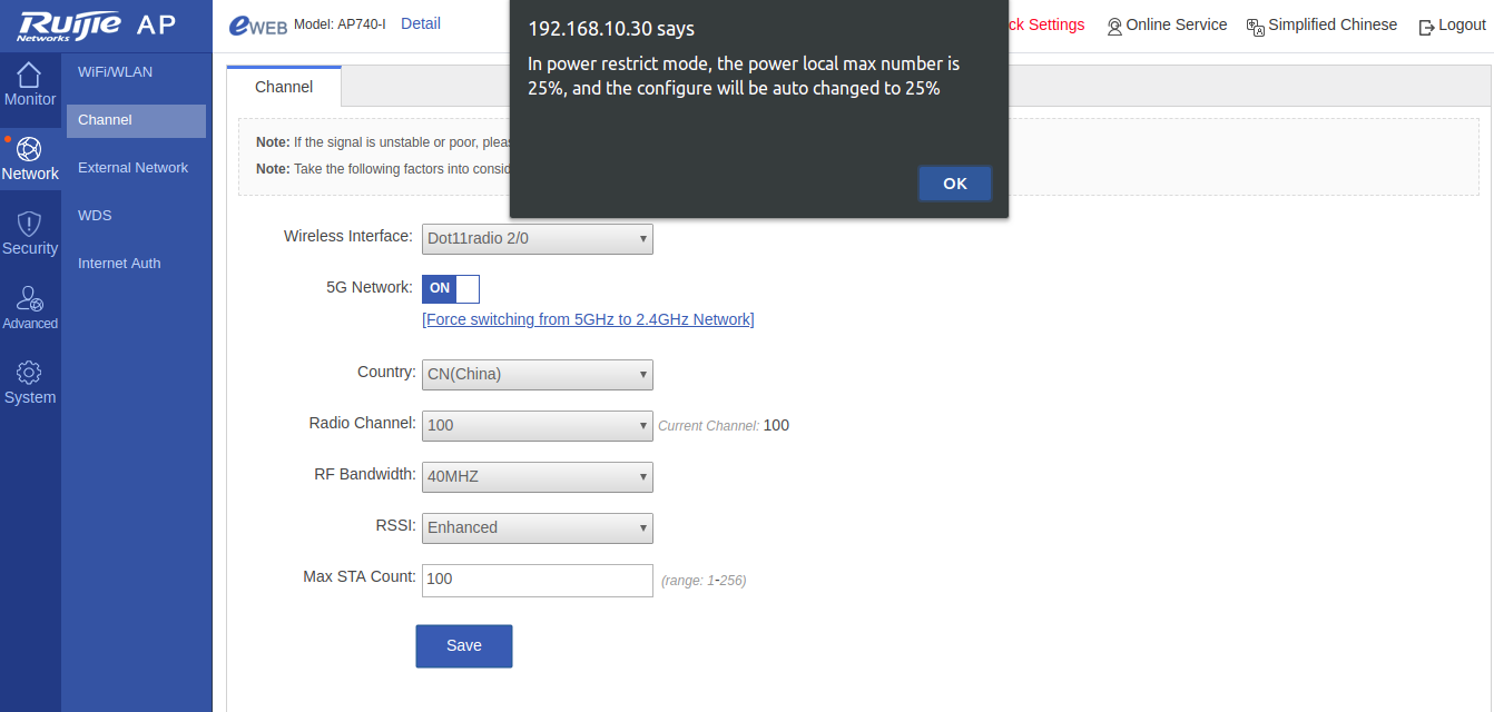

AP EWEB shows the AP is in power restrict mode and power cannot be adjusted
8738 0 2018-7-24 14:15:25
Description:
When login to AP's EWEB UI and try to adjust RF transmission power, the web page prompts warning as below:
Solution:
From the warning showed above, it indicates this AP model requires POE+ as power supply, but the POE switch or injector can only provides POE currently. And the AP will work under power restrict mode due to insufficient power supply. it needs to verify whether the POE switch/injector support 802.3at(POE+) standard.
