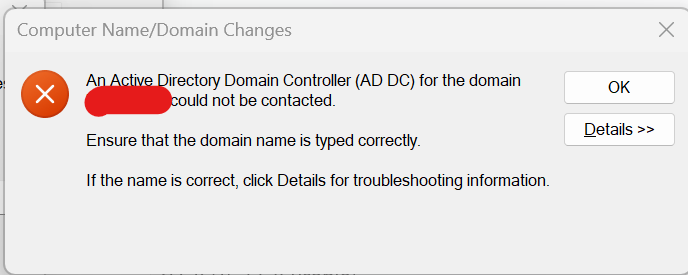

I have AD domain controller setup on my network though I have an error joining workstations to the domain (see screenshot below). The domain controller is pingable on the workstation end but I suspect it cannot resolve the domain where to go. Can someone help me on this?

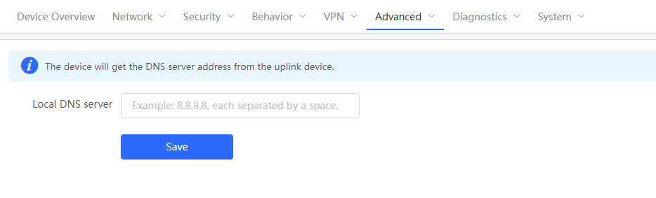

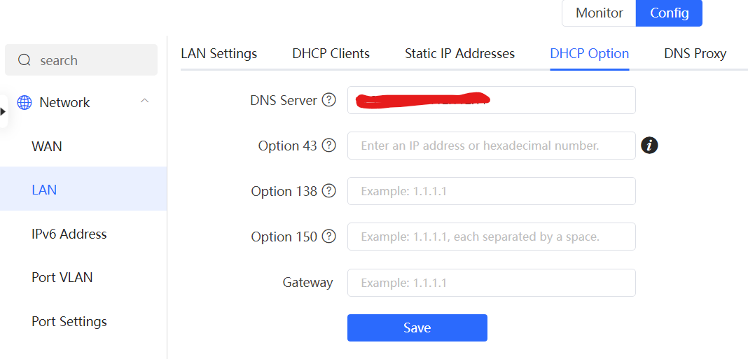

Though I think I need to input somewhere the IP address where my DNS should point which is my domain controller within my ruijie router. Maybe in the Local DNS server (see screenshot) below?

Dear JR Omega,
When the domain controller is pingable on the workstation end, did you ping the IP address or the domain?
Jayden
0 2024-2-2 11:31:33 View all replies
GTAC-Jayden replied at 2024-2-1 17:49
Dear JR Omega,
When the domain controller is pingable on the workstation end, did you ping the IP a ...
the IP address from the workstation as it is not yet within the domain so the DNS name is not yet possible.
0 2024-2-4 23:00:19 View all replies
JR Omega replied at 2024-2-2 11:31
the IP address from the workstation as it is not yet within the domain so the DNS name is not yet  ...
Dear JR Omega,
If you are using a private DNS server, please kindly note the workstation IP and its corresponding hostnames should be added to the DNS server.
Jayden
0 2024-4-25 08:35:18 View all replies
try this
In ruijie - Setup the DNS Server pointing to your Primary domain controller address.
Next go your Primary domain controller then configure the DNS server to Google DNS or desired DNS settings.
