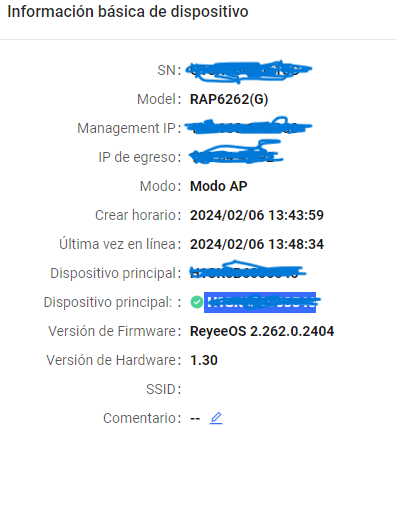

connect a UFO AP model RAP6262(G) with my EG105GW(T) router via mesh and from one moment to the next it goes offline, I have restored it, I connect it, the process begins and then it goes offline

It worked yesterday for a while but then it stopped working, the version of both devices is 2.62.0.2404
I factory reset the AP and then I rescan the ACCESS POINT MESH, it finds the device, it starts to adopt it and then it shows that it is offline, I am doing this procedure 2 meters from the GW
